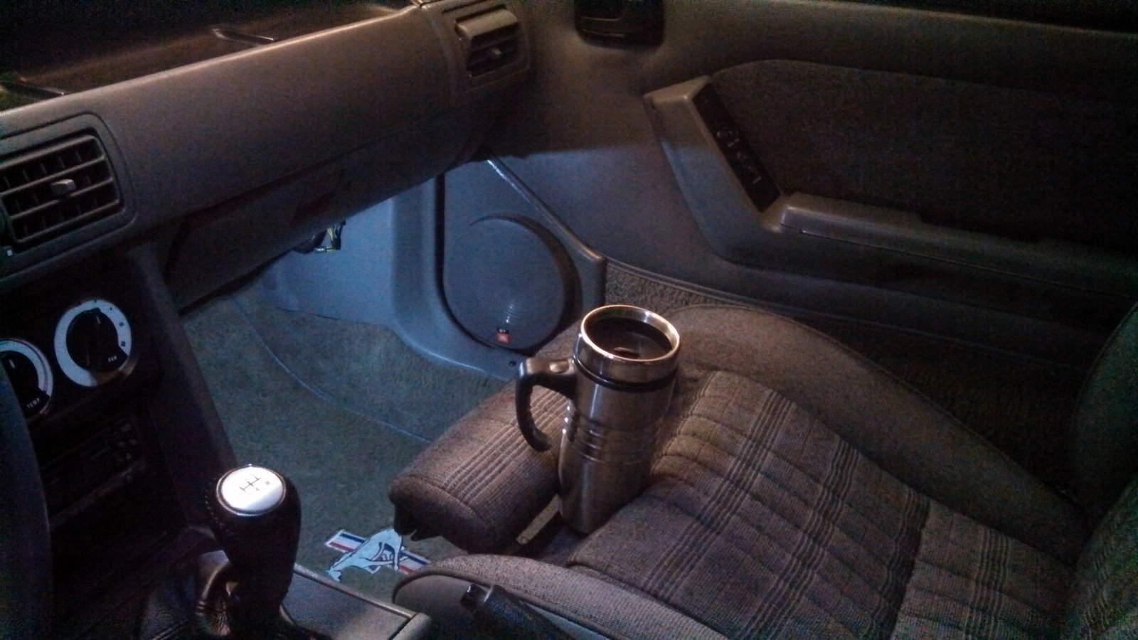

  5. between the ebrake and passenger seat for me.....
    Blackjack, TCKTGTR and krazedstang like this.
  6. Been there done that too.
  7. Yep, me too. But, I know I need to come up with a better solution because its only a matter of time until I dump Coke all over my carpet. :fuss:
  8. That's the reason I fabbed mine up.
  9. ya hand brake seat cushion wedge = coffee all over the console and carpet...
