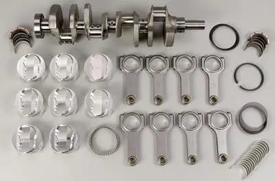

  6. Awesome, i heard mmr had good kits and i found a mmr 600 forged 4.6 forged rotating assembly on there website for 1500
    Includes:
    600 HP Ford Racing Cast Iron Crankshaft (6 bolt)
    MMR 4340 Forged I-beam Rods
    Manley Forged Pistons with tool steel Pins -18cc (makes 9.5 to 1 on 99-04 2V & 8.6 to 1 on 2005-2010 3V)
    Total Seal Rings
    Clevite Performance Rod and Main bearings
    1 year Warranty
    400600RA
  7. Look in the description. The crank is cast, not forged... Basically what you have now in a stock crank. If your crank is good, it can just be polished and its ready to reinstall.... Just get rods and pistons... I have seen some killer deals on rods and pistons.. Shop around...
