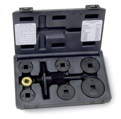

    You can't use a c-clamp to compress it like on a standard caliper/piston because the pistons on the rear twist or screw into the caliper. Requires a special tool to compress. Go rent/borrow from AutoZone.

    ya I found that out after calling 4 different ford places.. I ended up paying $30 for the tool when I could have probably used pliers. I drove it after that and used the e brake and it works great. the problem I'm having now is that I need to turn my front rotors and I can't get the front driverside rotor off. I still don't have a shop manual and I don't know if theres a special way or not but the passenger side came off fine. I've used map gas, wd-40 and a rubber mallet and it wont budge. any ideas?
