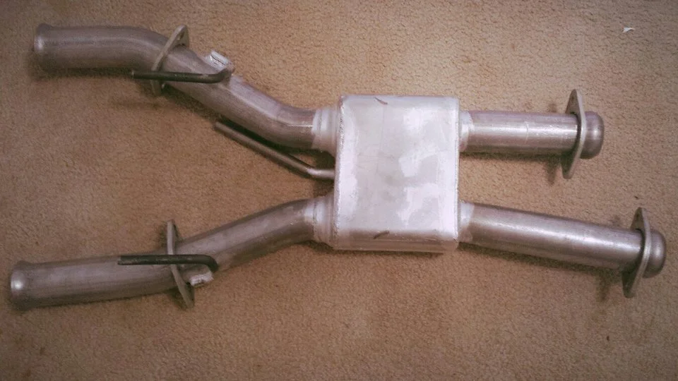

    Going to start replacing some basic stock items on my 89. I bought the car with a new flow master cat back set up. I am considering replacing the headers and stock H. I am not gong to far with the motor any time soon, maybe change the intake. If I go extreme I will pull the stock motor and go big. So I will stick with the shorty headers for now. I only plan on cruising on nice days, no track visits. I have been checking out the new H and X pipes and unsure of the direction I should go with. I will go with the off road, don't have to worry about emission testing, just need some advice from someone who has installed a replacement. I like the sound I have now and that seems that is the main difference, or in my situation the main difference. There is a newer Saleen and a couple of late model 00 Cobras in my area and I don't really care for the Fast and Furious sound there exhaust puts out. Not sure if that is from an X pipe. I was told that I should put an X pipe on to go with the equal length shortys. I am probably only going to do minor bolt ons to this motor, intake and gears. Anyone educate me some on this topic. Thanks

    H=deeper n' throaty
    X=raspy

    I've had them both, imo buy for quality as for the sound isn't different enough to make a choice.
    Stay away from the cheaper brands and any one that doesn't give you a little room for adjustment.
    I like bassani because the fit and quality is great, and it will likely outlast the car.

    not much of a power difference so what it comes down to is the good description Grabbin' asphalt gave...i went with shorty h-pipe i love the deeper n' throaty sound especially right after getting a deeper n' throaty

    I've had both, and the H pipe has a much throatier sound, while the X pipe is somewhat quieter, maybe a little more refined. If you want the classic muscle car sound, H pipe all the way.

    I found any balance pipe helps quiet the car down a bit too.

    I say long tubes and h pipe and you'll never look back, but if you're stuck on shorties, then h pipe over x

    H pipe all the way-x pipes produce a sound that is too raspy for my taste. If you have an AOD certain X pipes won't clear btw.

    My BBK X pipe is not raspy, either with Flowmasters or Super Turbos. The cat pipe I am putting on is an X pipe for a little more power too. Based on the other cars I put a cheap H pipe in, I think any crossover pipe will help mellow the tone a bit. I wish they killed drone.

    Agreed, the x isn't raspy on a pushrod fox.

    Personally I wouldn't put a pro chamber on my lawn mower. I had one and could not stand the sound of it. As far as an X being "raspy", it depends more on your mufflers than the mid pipe. I wouldn't call my car raspy, but it's definitely a higher pitch than most cars.

    Go h-pipe. i just made the switch from shortys/h pipe to long tube/x pipe. after the first 10min i hated the x pipe. Im putting the x pipe on craigslist and buying a h pipe.
