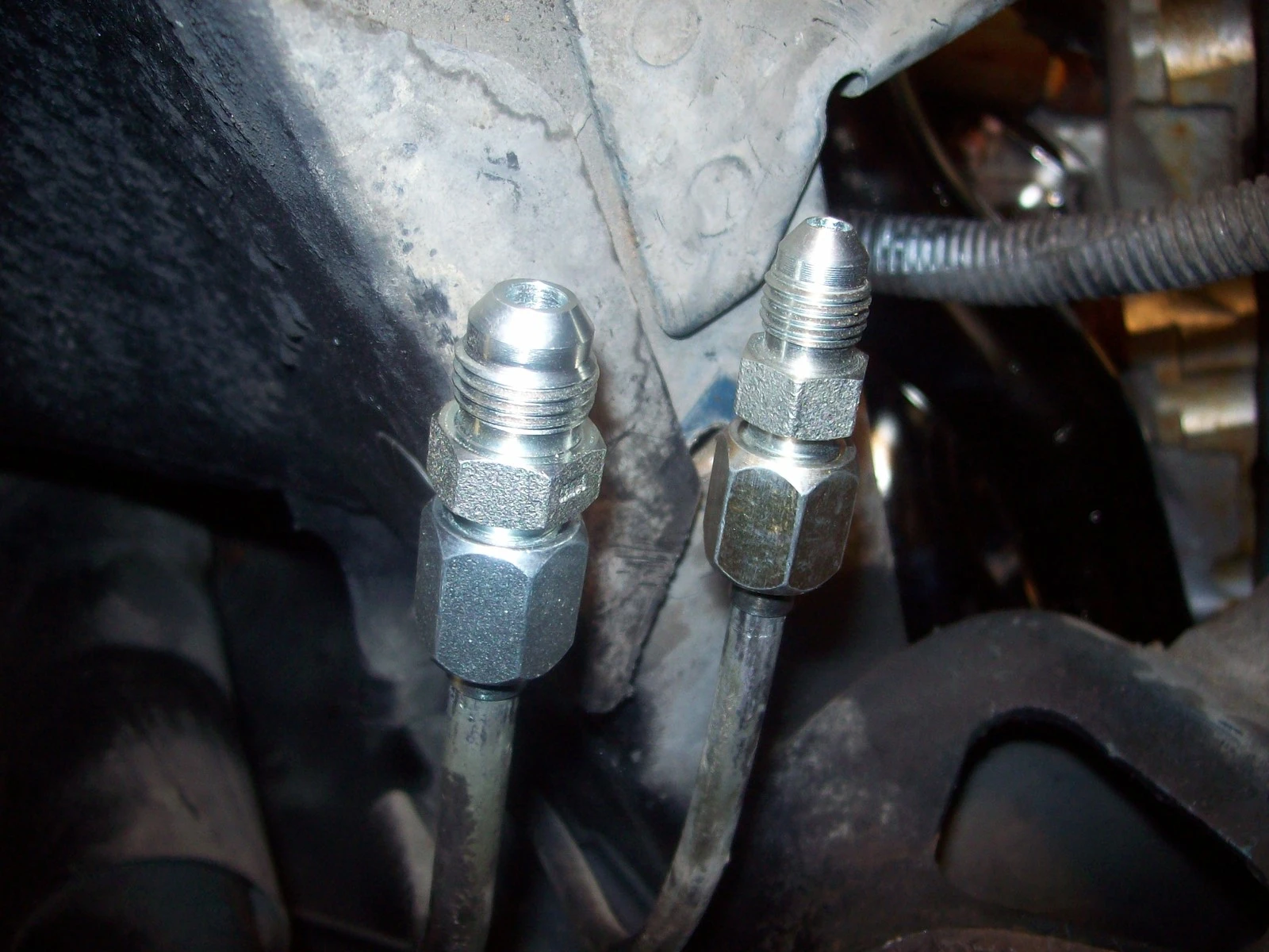

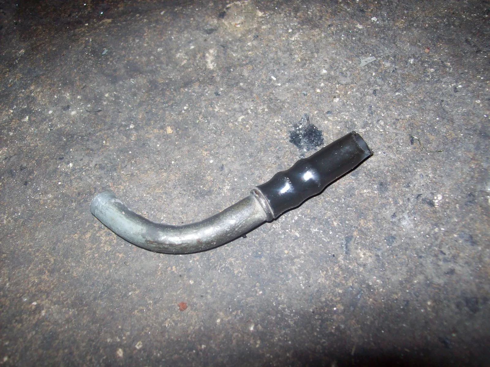

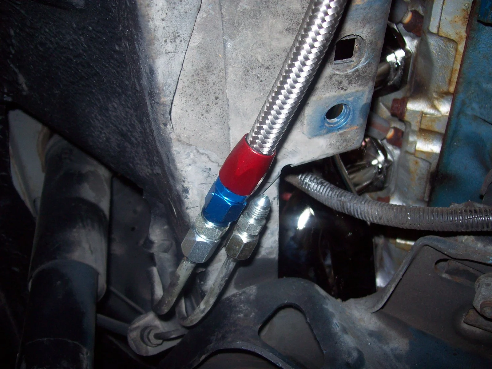

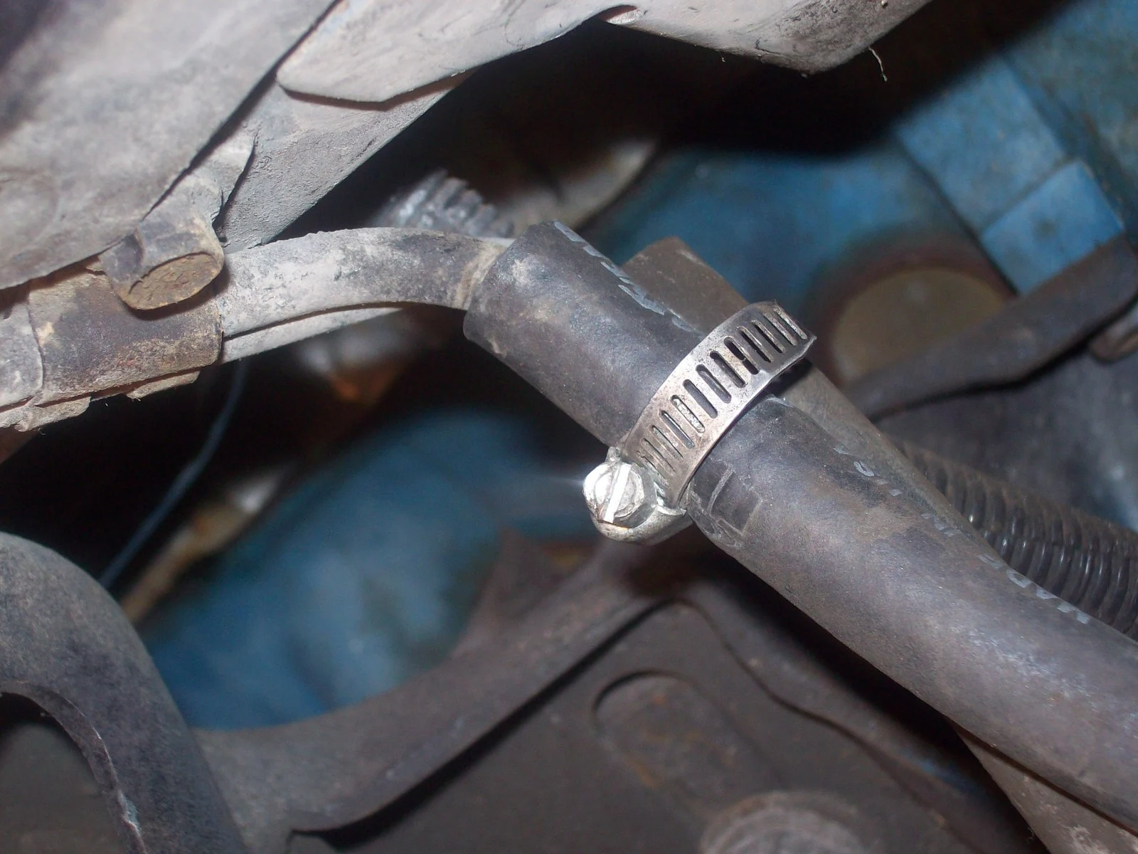

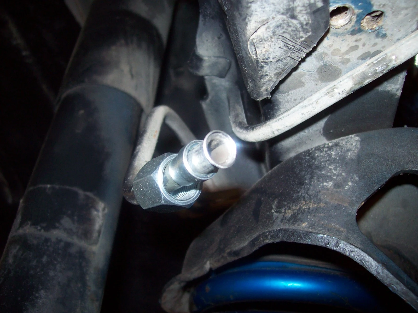

  9. When I bought my car someone had cut the quick connects off of the car side of the lines. They had rubber hose double clamped onto the stiff plastic part of the lines. I cut them back into the fenderwell where they are metal, flared them with a 37 degree flaring tool and added braided from there straight to the rail. I used -an fittings.
  10. I'm amazed that somebody thought that was a safe thing to do to your car. Some people :nonono:
    On second thought, I'm not amazed. This country is full of half-assed morons.
    Cory Berg likes this.

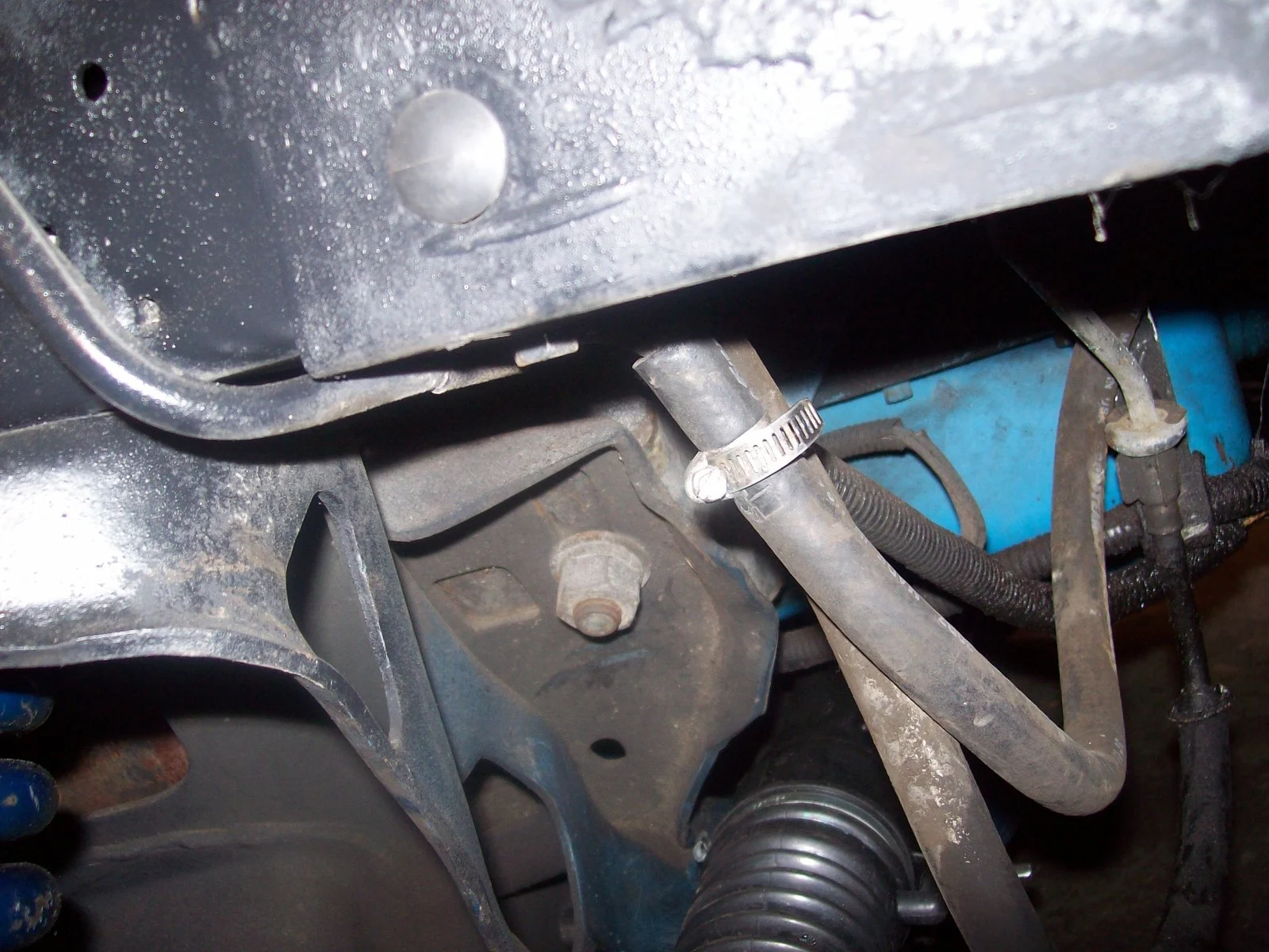

  11. I swear to god it had 20+ inches of rubber that looped down around the sway bar and back up. I was sure it would burn before I fixed it. It's awesome now. I made nice braided right into the fuel rail. It got rid of that BBK bs that came with the SSI intake too.
