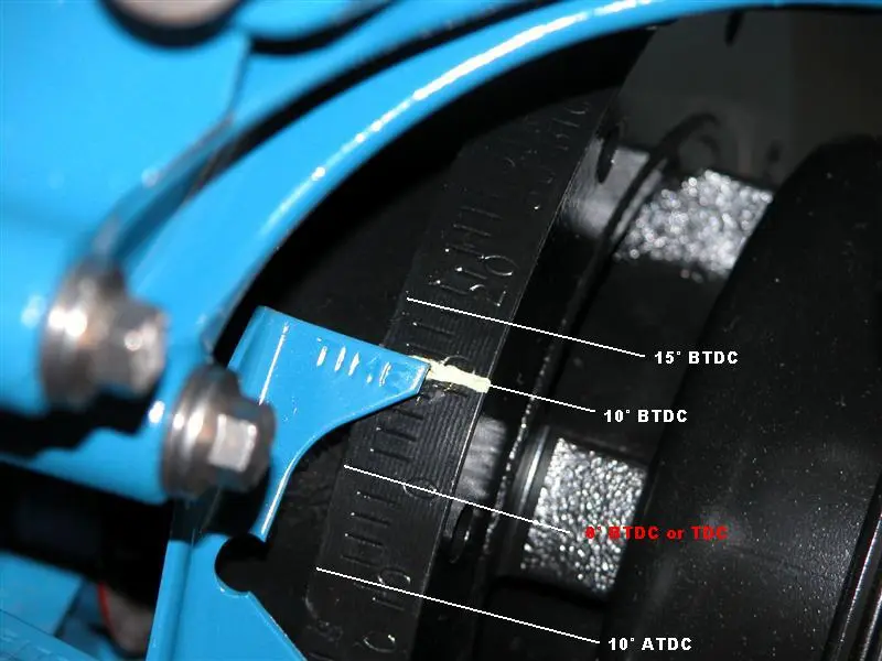

    The rocker arms were shimmed wrong, well at least some of them. Also there were two pushrods that were too long so we traded them out for some old ones. After we redid the rockers the timing was way off (I know wierd?). So we set the timing to a diagram where the little black deal (reluctor) was just ahead of the rotor and the plug wires had to be rearranged back a post each. Evidently the #1 marking under the cap doesn't mean squat and nobody should EVER pay any attention to it. I know that now.

    E) Timing- The black "reluctor" has to be pointed at 12:00. The rotor should be just behind it. The number 1 plug on the cap must be over the rotor or just after. That plug actually sits just over the black magnetic pickup (reluctor I think).

    Here's what we followed and it worked like a charm:
