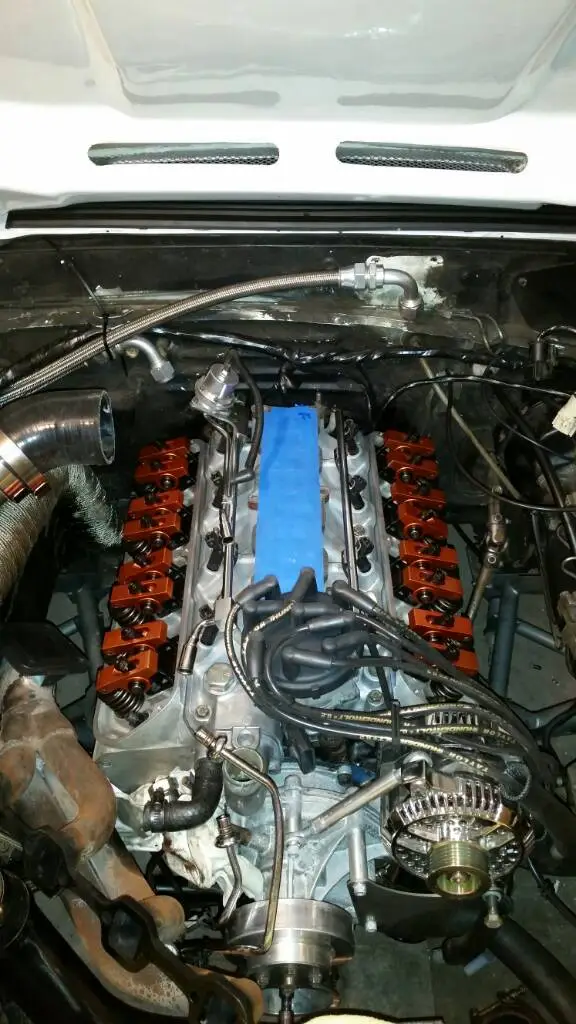

    Making some progress
  18. What, you want me to quit my day job? :eek:
