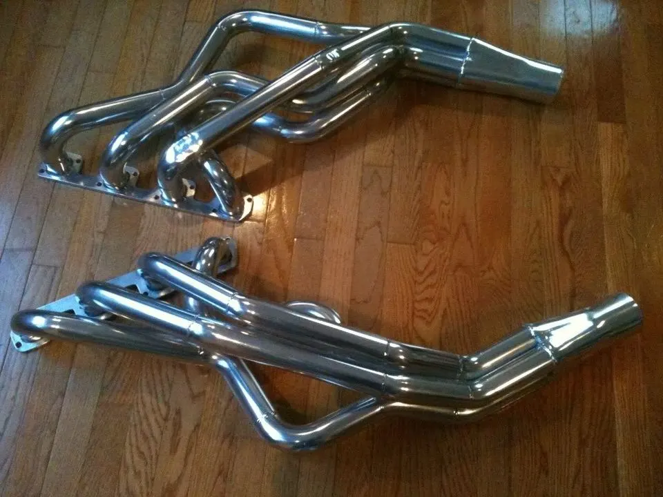

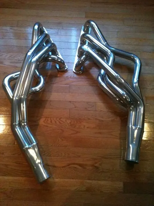

  3. Look at what got delivered back to me today :)
  4. They look amazing. I'm jealous. Mine are a pile of rust that I've covered in flame proof paint.
    Kurt
  5. It crossed my mind to do that Kurt but it never seems like a good long term option as well as header wrap. Shipping was $50 each way and $200 to get them coated. I used the place that Andy suggested on the previous page. Performance coatings out of Joplin MO
  6. they look great i might have to get my old bbks redone they are starting to not lok so nice at the flanges you should be up and running in no time now

  9. Andy's coating has held up for a few years and still look like new
  10. I'll keep that in mind. How much did it cost you to get those coated if you don't mind me asking. I think I'm just going to fork up the $500 for the BBK 1 and 3/4" headers with ceramic coating on them. I'd really like a set of headers Jet hot coated inside and out.
    Kurt
  11. It was $50 for shipping each way and $200 for the actual coating
