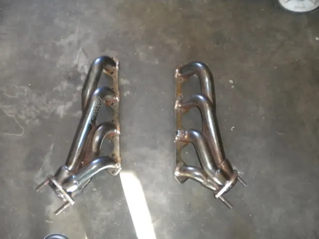

i installed these used BBK unequal lengths i got for a good price.(Adam95GT )

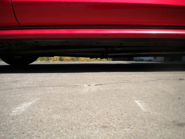

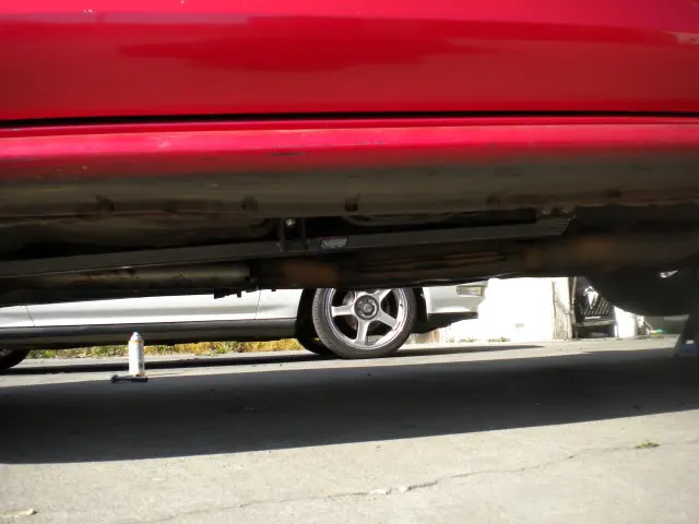

ground clearence is about the same.

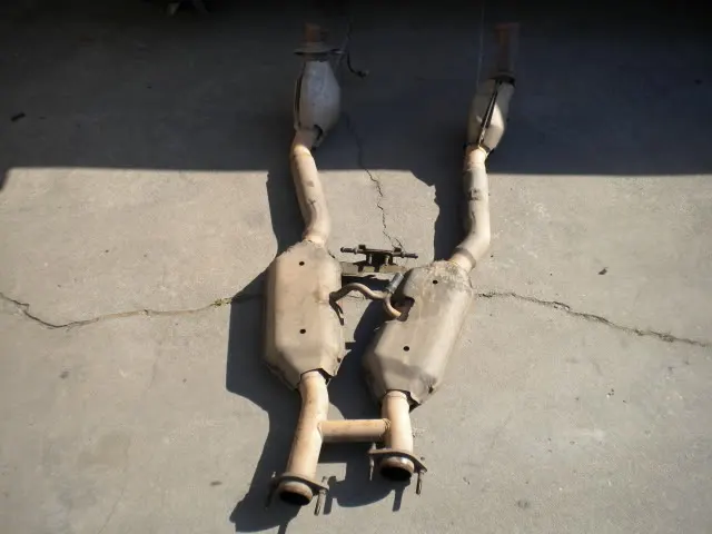

stock mid pipes

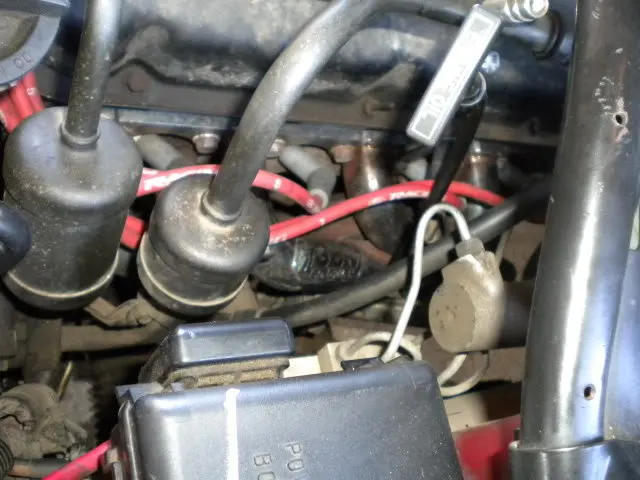

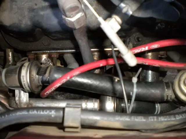

Headers installed

stock mid pipes

Headers installed
