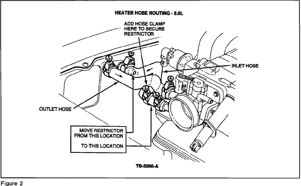

ghostang93 Member Mar 26, 2007 29 0 12 Pace, FL May 31, 2007 #1 May 31, 2007 #1 Can anyone post a diagram of pic of the routing of the heater hoses? Especially if you don't have a/c. Mine weren't hooked up when i bought the car and i'd like to at least have heat to help defog the windsheild.
TRWXXA Member Jan 18, 2003 190 1 19 RIGHT BEHIND YOU!!!... Made you look. May 31, 2007 #2 May 31, 2007 #2 Does this help at all?
ghostang93 Member Mar 26, 2007 29 0 12 Pace, FL May 31, 2007 #3 May 31, 2007 #3 Actually I think it will. Thanks
