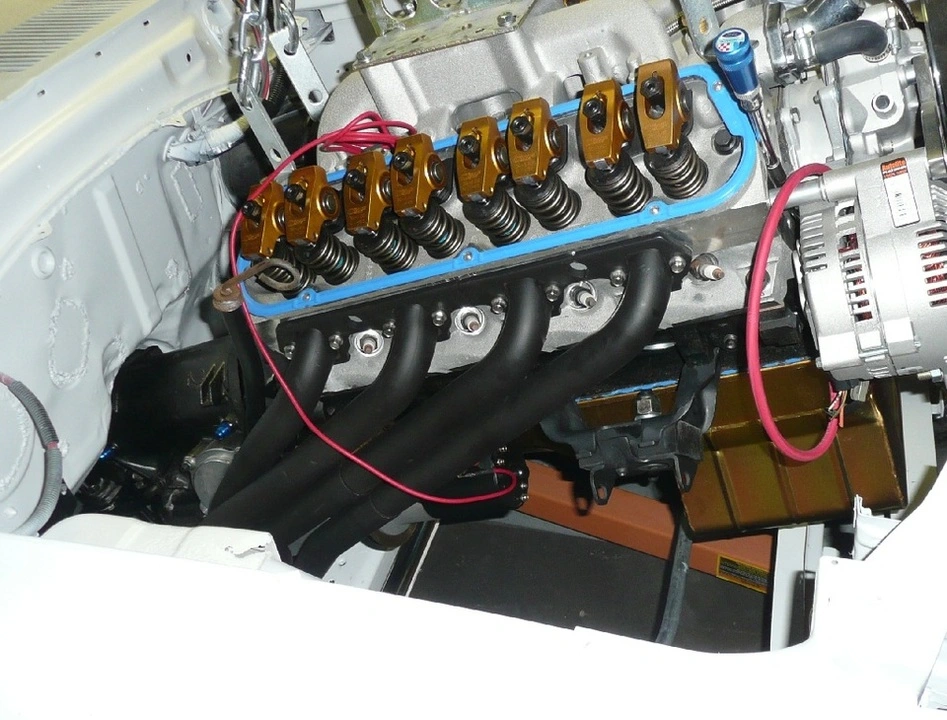

    The motor on the stand for the car is a
    Ballanced and blueprinted..
    289 HIPO
    Keith Black 10(ish):1 pistons
    351w heads, shaved/ported/polished.
    Solid Lifter setup/roller rockers
    Some ungodly huge cam,
    and alum intake manifold
    and headers
    with a C4 Manual valve body tranny and a 3500 stall
    The car has been sitting since 1992, with the air care motor in it.. Fired up first try.. I plan on driving the 302 aircare motor that is in it for a while untill i can figure out what to do with the 289 as there was clearly a design flaw made by the machine shop that built it..

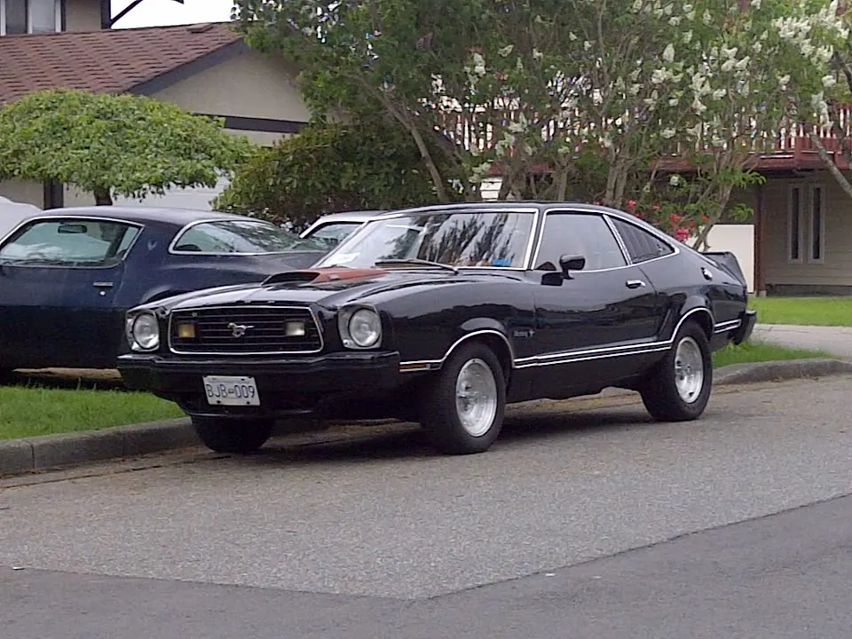

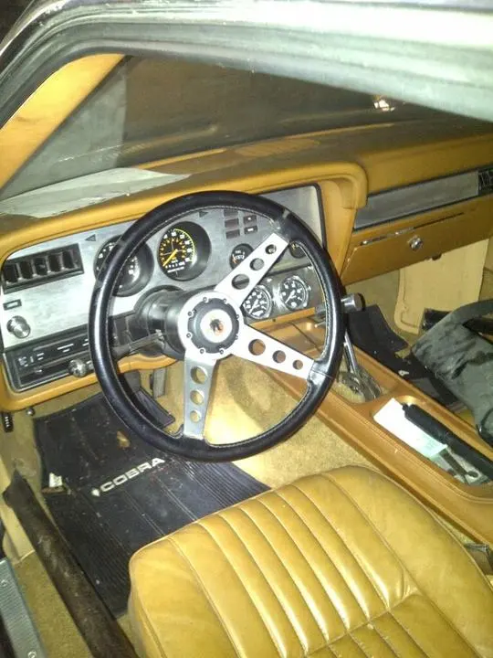

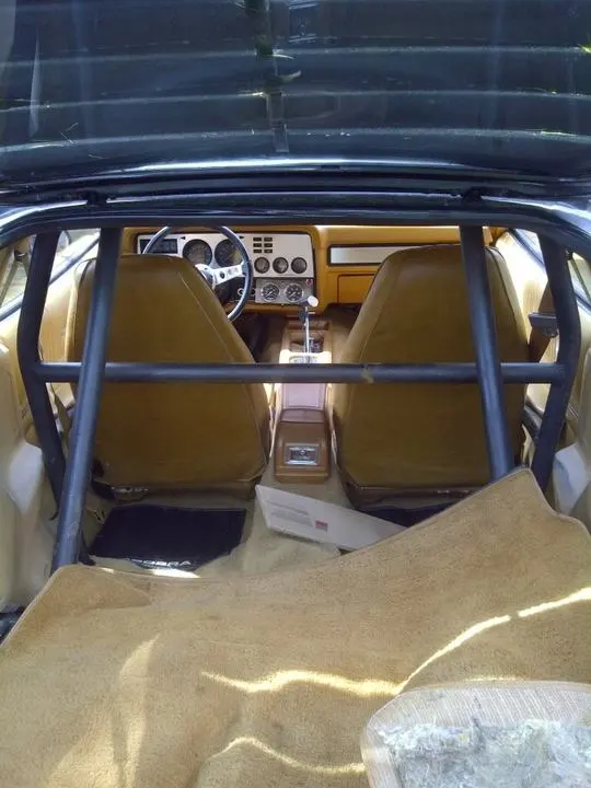

    As you guys can see she is awefully dusty and dirty, has been sitting in that spot for the last 9 years without moving..
    So, Time to query you guys..
    Turn the key to On, all dash lights come on, have power in spots where i should.. Except the coil.. when cranking the car over it starts and runs aslong as the key is in the start position and the car is cranking.. as soon as the key is turned to "on" it cuts power to the coil.. For the time being to get it flashed up.. I ran direct power to the coil with an inline switch.. So that is the issue.. any easy explination for this? or am I off to hunt for a wiring gremlin?:shrug:

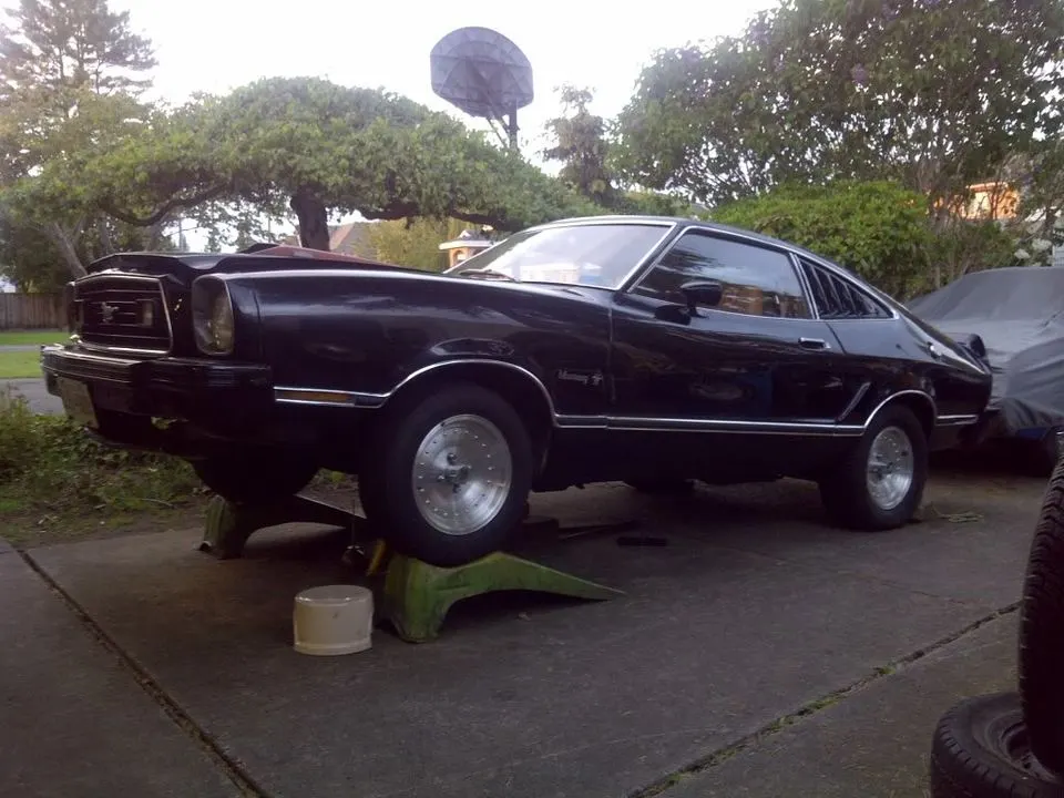

  5. Alrighty, just picked the car up..
    And already have ran into some issues, Ignition missfire, and randomly shuts it self off.. I am pointing at the duraspark box atm, so.. my first question..

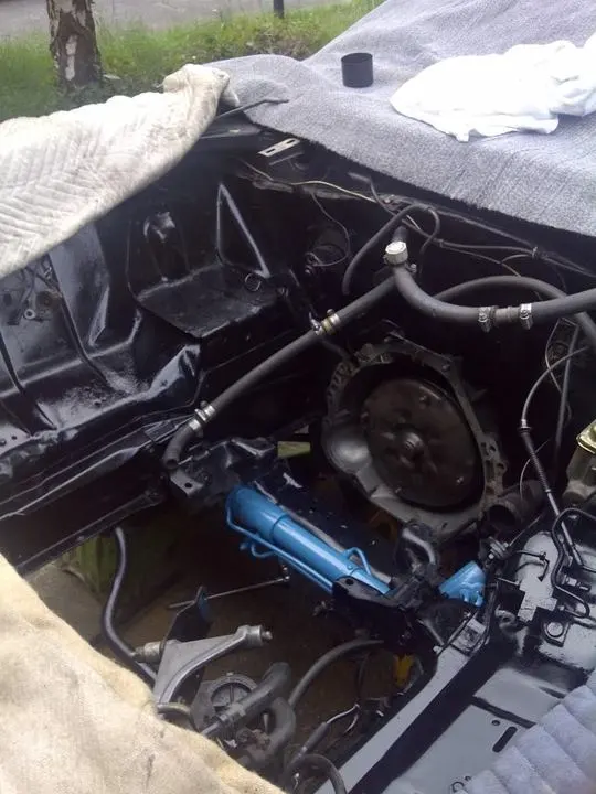

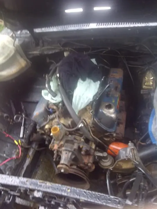

  11. Alrighty got the engine out tonight, painted the engine bay, stripped what parts I will need.. Yadda yadda yadda..
    Tore into the engine for my own knolage and piece of mind..
    It showed, 1 bent push rod on intake valve on cyl 3.. Slightly bent intake valve on cyl number 3. Looks like an impact mark on the top of the piston.. And a ****ty headgaskit, probably the origional from 1976, possibly a leak, but no water/oil mix, and no white smoke... Timing chain was also tight..
    Thinking that if the engine sat for the past 10 years of its life with cyl3 intake open, the spring may have lost some pressure and 'floated' the valve, causing said issues..
    In conclusion.. The heads on the new motor are not "hipo" heads, they are casting #13.. Although they have screw in studs, larger valves, guide plates and a heavy port and polish, I am sure they will be more than sufficiant untill I get the built 289 in the car..

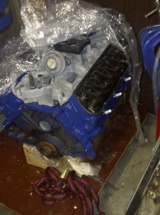

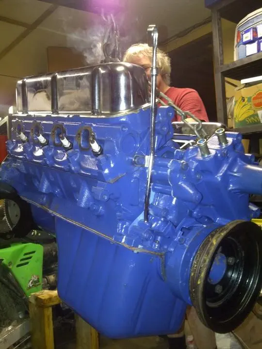

  14. Alrighty, a little eye candy for you guys..
    Painted up :d
    Does anyone know how i can identify that intake manifold on my new motor? it looks like it uses a valley pan type gaskit, and from what my parts guy is telling me the 302 never came with a valley pan type gaskit? any help on that would be much appriciated..
  15. Your guy is right, no valley pan gaskets on a Ford 302.
    I can't identify it the intake, what do the cast markings say on it? With the EGR on it, it looks like a Ford factory manifold. Is there an air gap below the runners? Hard to see in the pic.
    BTW, the car looks excellent, nice condition.

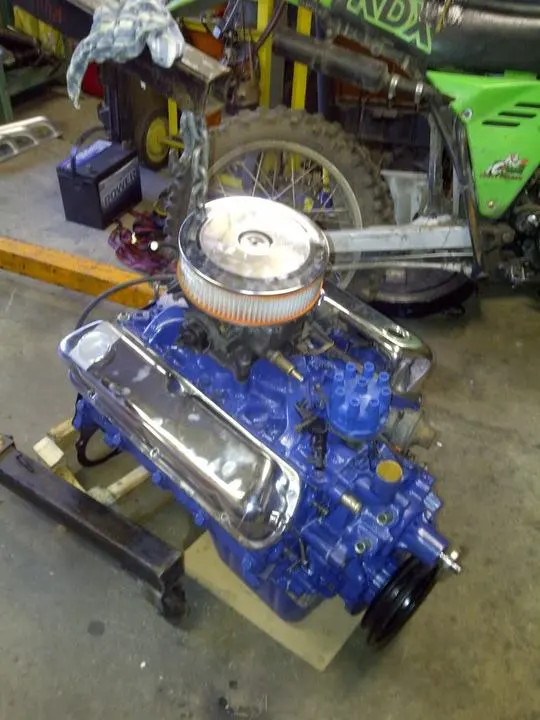

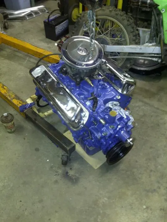

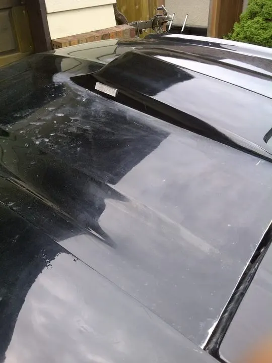

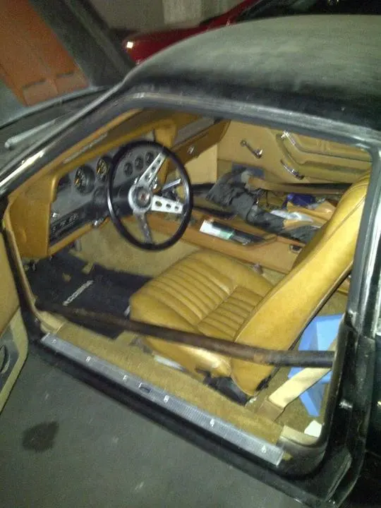

  17. Alrighty, So been getting a bunch more work done to the stang.. I will feed you guys more pictures..

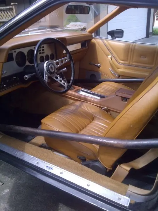

    Cleaned the interior:

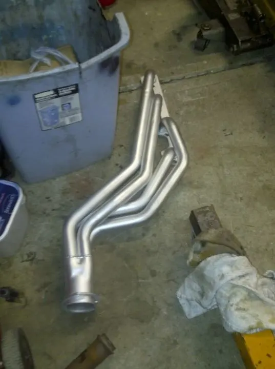

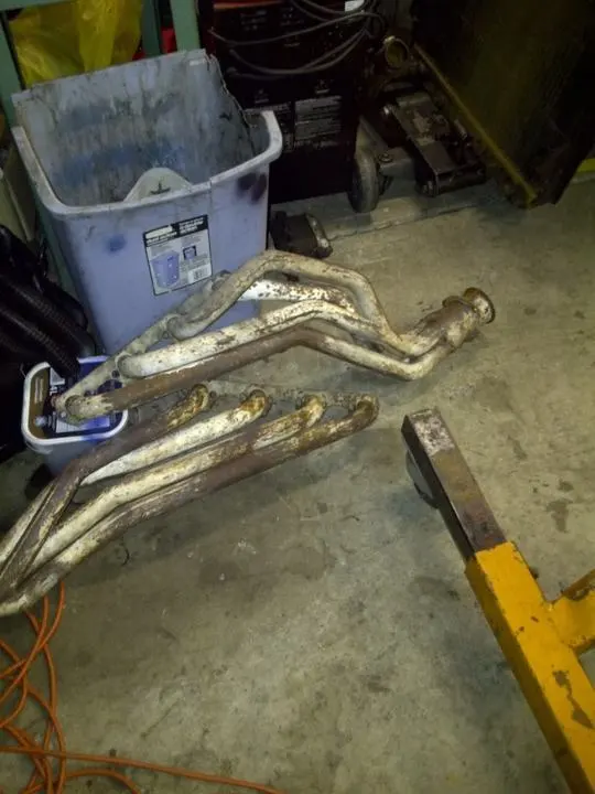

    Picked up my headers from storage:
    Painted using plastikote, NEVER USE THIS ****!
    Finished assembly of engine:
    And lastly, painted the hoodscoop on the car, still need to polish the hood..
    The motor will be dropped in this coming weekend, wich brings me to my next question.. HOW do I install the headers?
    Lay the starter on the cross member, headers on the inner fender's and lower the motor and carress everything into place?
    It looks like this job could be involving alot of swearing and soforth..
    Also, how to flowmaster origional 40's sound on a stock/mild 302 with headers, 2.5" piping? Thinking about replacing with these as my current muffler has a huge hole in it..
  18. Looks great so far, the headers look so much better :)
    I bolted the headers, starter, motor mounts, and trans together, then lowered them all in at the same time. I used a load leveler on the cherry picker, a must to make the job easier. I just took my time and slowly lowered it in, took about 45 minutes to bolt it in by myself.
    My headers are Hookers and didn't have the collector flanges welded on yet, so I don't know if your headers will clear as easily, but it should as I had plenty of clearence.

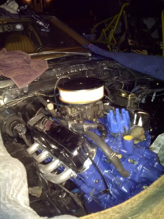

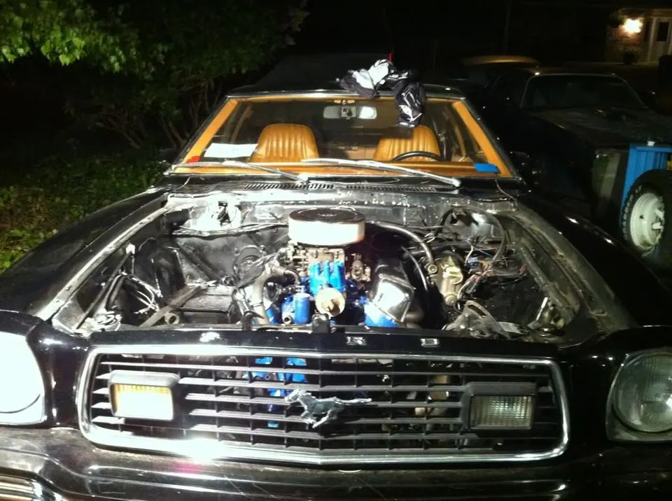

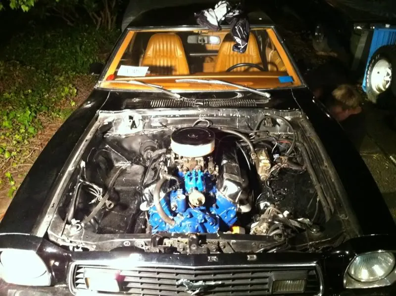

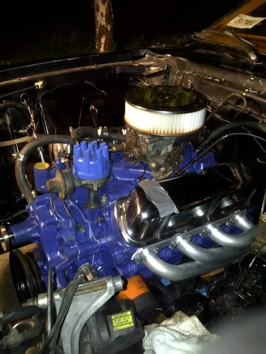

  19. ahh james, that looks CLEAN!

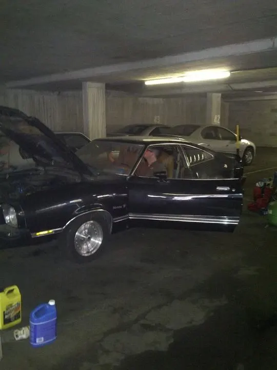

    So after the Canucks loss, I decided to take some agression out on the car.. Slammed some parts onto the motor and got it in for 1am.. Not bad for my first go, with headers added into the mix too.. Still got to do some more random things, but its close..
    Some more pics..
    We ended up laying the headers in the bay, and as we dropped the engine down into the bay, we made sure to clear the headers, and pull them up into position, it worked out well, defently sacrificed alot of the ****ty plastikote paint, I think when i put the 289 in the car I will send the headers out to be ceramic coated.
