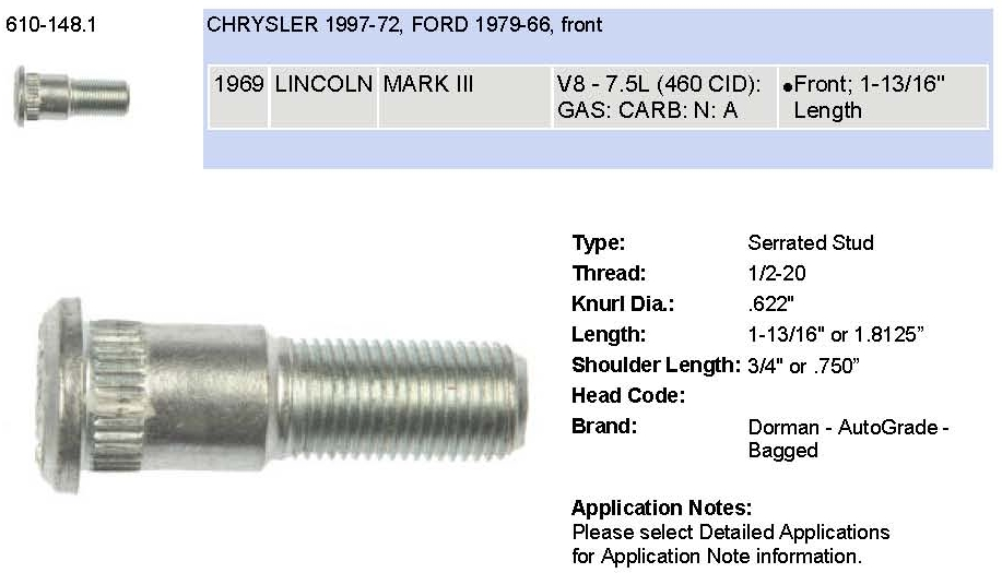

Since most cars are either "Lug Centered" or "Hub Centered" I took the "Lug Centered" approach for mine. After measuring the rotor stud holes and measuring my wheels lug holes I choose the DORMAN 610-148.1 stud that perfectly fit my axles and had a shoulder length of .750 in with enough meat to fit at least .130 in inside my wheel to center it.
The only mod I did was to drill out the rotors holes with a .625 in bit and everything fitted perfectly. I have close to .495 of thread for the wheel nut and the wheels already had the .625 in dia holes in them for a perfect centering. This stud may fit other wheels since only .130 in is inserted into the wheel holes. Here are the specs of the stud.
