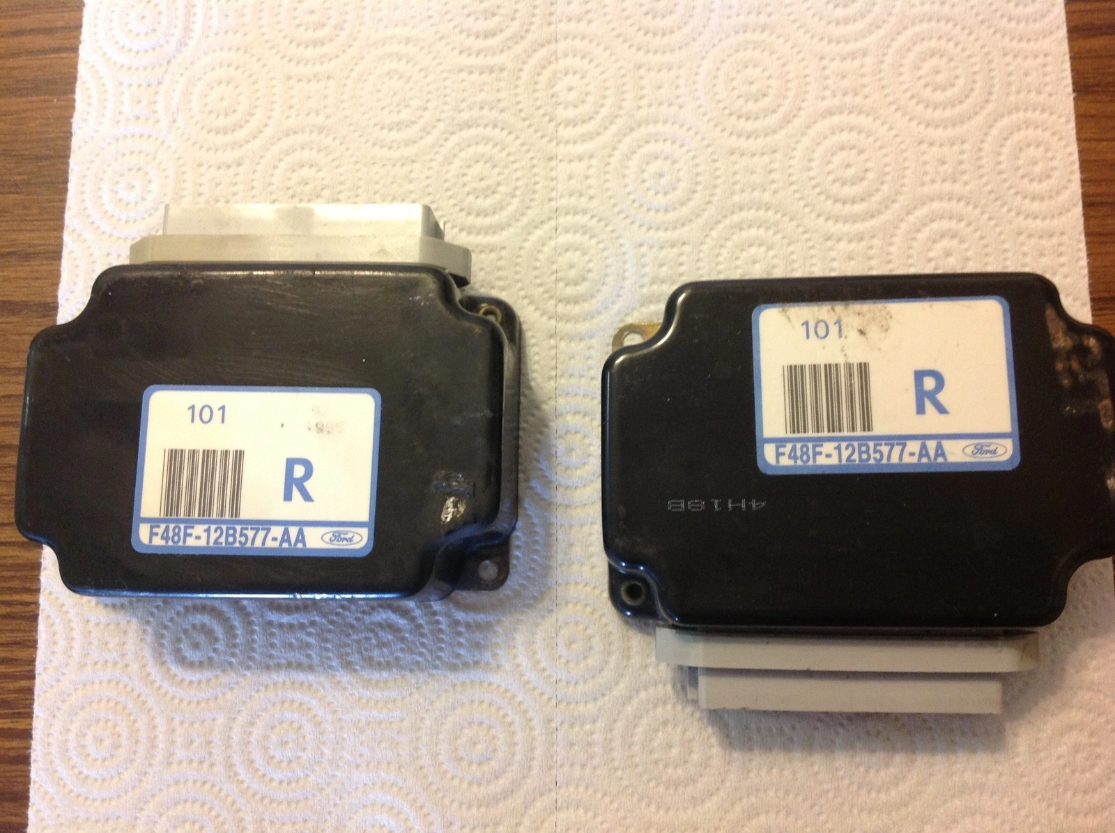

    Ok,so there were 2 issues. One, was a slammed full IAC which was not even installed securly (vacuum leak). Two, was a bad CCRM. The CCRM on the left is the refurbished unit from ebay. The one on the right is the old unit.
    When I plugged in the refurbished unit it was like a new car. Thank the Lord. The car came alive. As an unexpected bonus: I though maybe my fuel pump was going bad because it was so loud, and because of the hesitation/stuttering. However, with the new CCRM the pump is easily half as loud as it used to be, and there is no stuttering (vacuum fix probably helped the stuttering though).
    I plan on having a friend, who is a professional electronics repair/builder, refurbish all the relays in the old CCRM unit. Maybe it will go up for sale. Maybe it will be a spare. Any thoughts guys?
