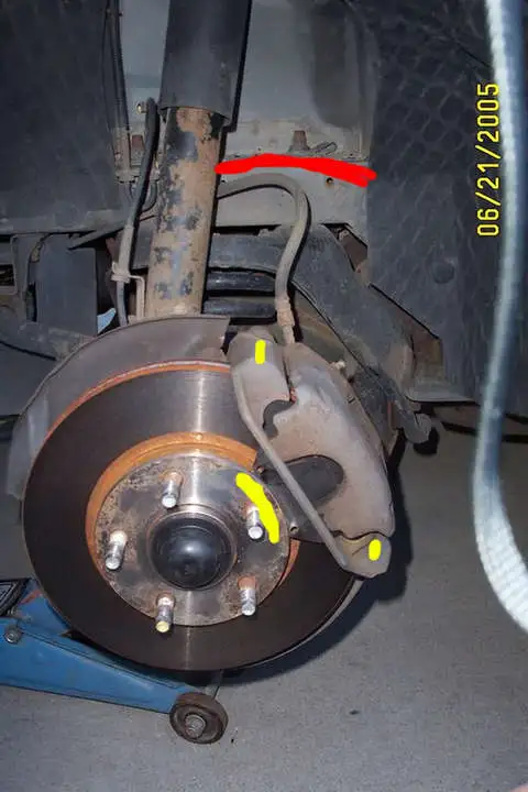

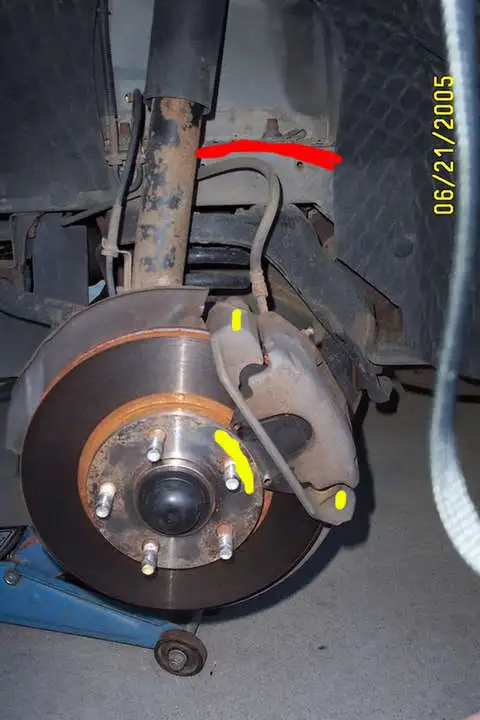

5. The box came with a few loose metal clips, other than the ones already attached to the pads. What are those for?
Would it be possible to get a picture of them? Only metal clip I can think of is shown here http://img.photobucket.com/albums/v75/Dusstbuster/Picture_1722.jpg Otherwise they might be for the rear brakes. It's been so long I'm starting to forget things!
