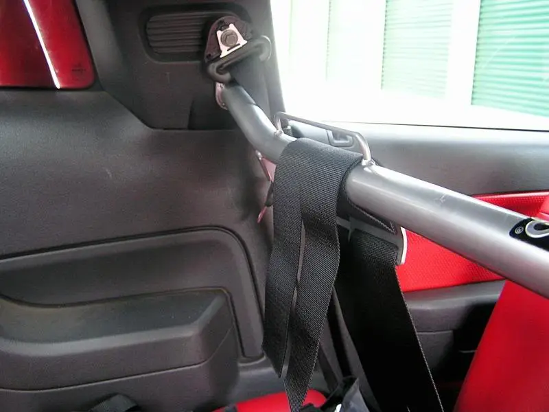

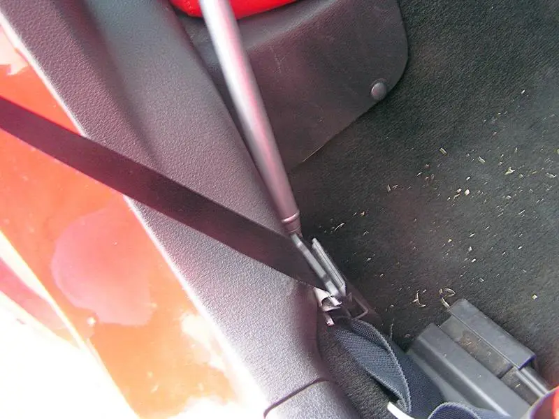

    Here's some more pics of the harness bar. I'm sorry I didn't get more of the lap belt mounting points but that would mean removing the seats.

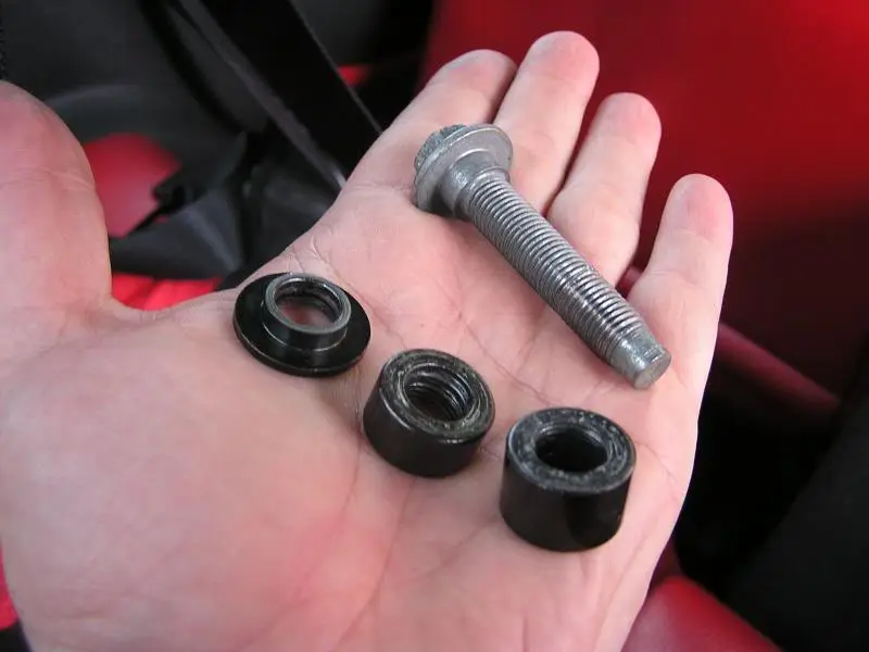

    Here's the hardware from the stock shoulder belt mounts.
    Here's the view from the back seat with bar in place.
    Here's the lap belt mount on the outside (just behind the door). You can kind of see the lap belt for the harness. I just removed the stocker, sandwiched the downtube mounting plate and the harness lap belt between the stock seat belt and the car, and bolted it back up. It's a 45 torx bit I think.

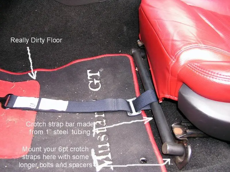

    A better view of the crotch strap bar my friend made. It's bolted down to the front seat brackets.
    You can see where the seat brackets are. I think you could bolt the crotch straps for a six point harness down where my bar bolts down. You'd just need some longer bolts and spacers. Or, you could just drill thru the floor and mount the crotch straps with some eye bolts. Saferacer has those too, along with the regulation 4 inch square backing plates. And last but not least, this is how the harness should fit, well, if you're as fat as me that is.

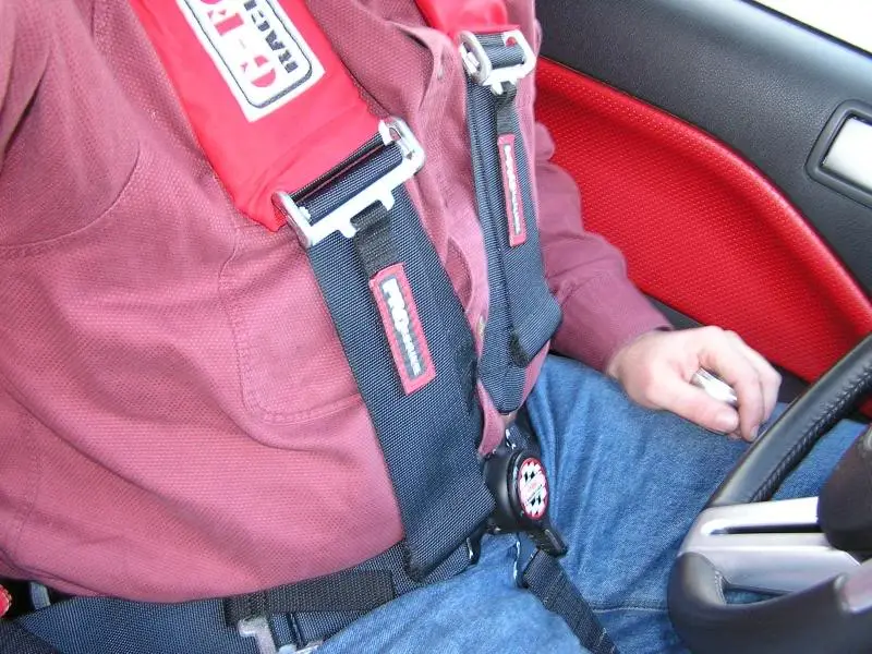

    The camlock buckle should be LOW, just above your you know what.
