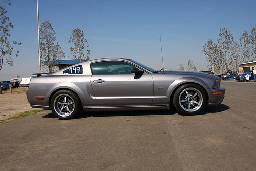

  1. No, whatever you do don't get them! Especially if you have a Tungsten Grey GT
    Just kidding, they are amazing wheels. I just don't want anyone else to get them. It ruins the combo if it becomes overly hackneyed. Like what happened to the Konig Beyond's. Great looking wheel. There's just too many of them running around out there. Or Lamborghini's and HRE's. It's no longer that unique.
    The Omega's are lightweight, inexpensive, deep dish and WIDE. I staggered them with 18x9F and the 18x10R. I'm satisfied with the looks and performance.

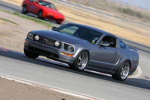

  2. LOL I knew they looked close but wasn't sure cause it was a moving picture. PS no it a redfire.
