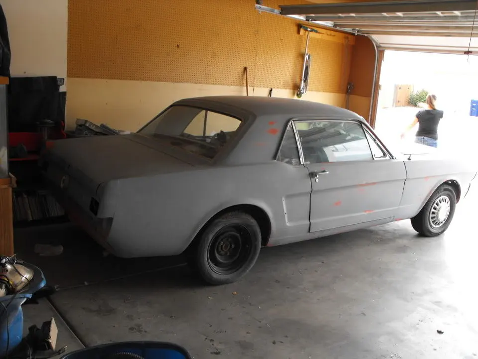

    I have a 1965 with a 2 barrel 289. I bought the car over 12 years ago and it has sat in the New Mexico desert until about a year ago. I will post pictures of her once I get into my photobucket account again. Goals for the car are: driven 100+ days out of the year, drag strip a couple times a year and maybe one road course event. Most of the suspension parts (upper and lower control arms) have road grime built up on them and I am not sure how much of a benefit it would be to completely replace them with new parts or just rebuild what I have.

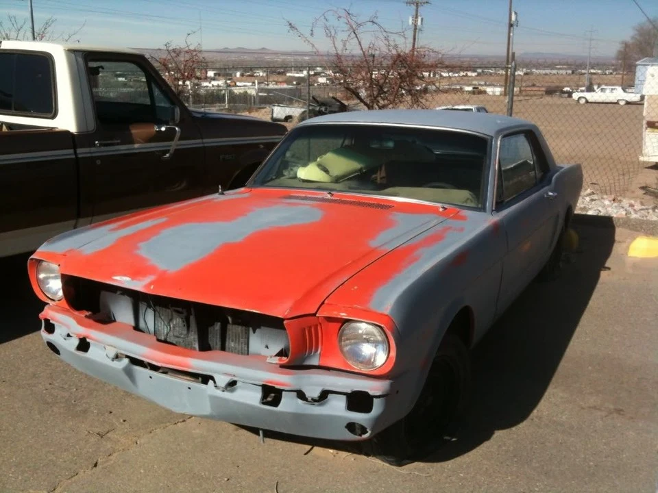

    Here she is...

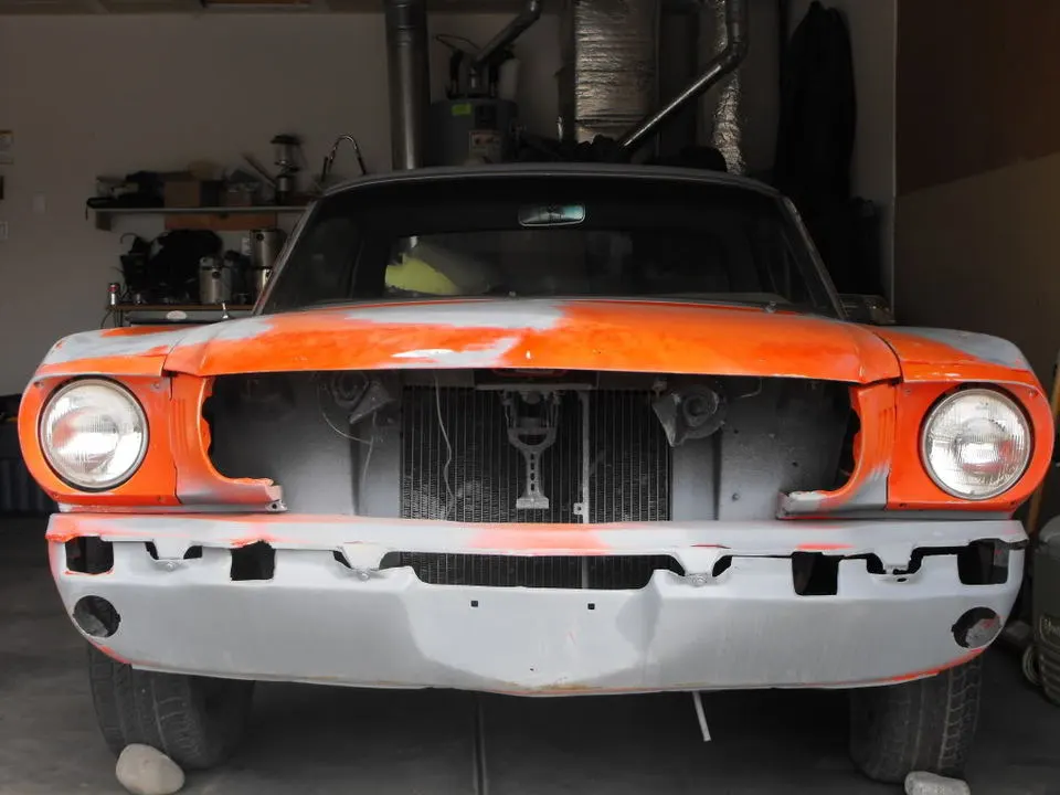

    This weekend I rolled her out of the garage and pressure washed some of the dirt and grime off of her. I see some surface rust on some suspension and steering parts but nothing major. Also removed the fuel tank and radiator and will be taking it to a radiator shop to have them both flushed. I am going to try and reuse as many things like the fuel tank and radiator as possible because I think I am going to need to replace the wiring on the car. I found a lot of splices and wires that go no where. Any ideas on what harness I should get and how much it might cost to have a classic car shop do the work?
    Suspension wise I may end up going with one of the kits from Mustang Depot or Mustang Plus. I know their parts are just like factory but I have to find some savings for the wiring somewhere.
