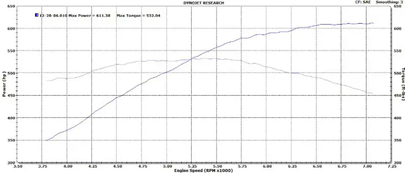

  11. If you want to get really crazy, I would say go 408W+ on the motor. The chasis dyno chart below is a dart aluminum blocked 434W with TEA 240cc Highports and a solid roller. Motor was set up for road racing. Plenty of torque there I think.
