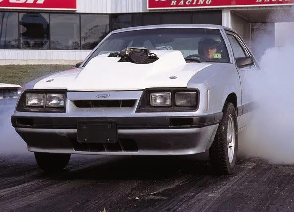

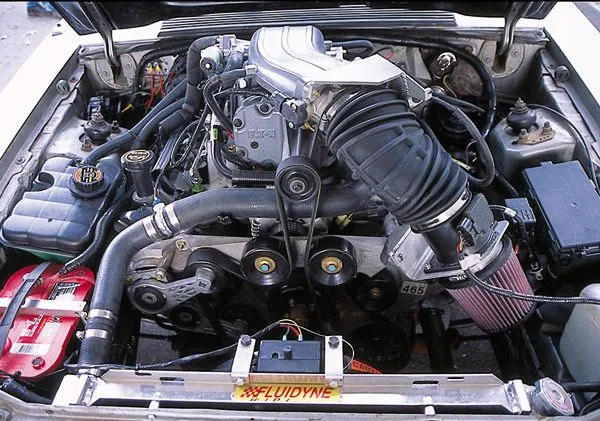

  13. I hope you've got a 10" cowl hood to go along with it. The Cobra/Lightning intercooler is one thick mo-fo. Remember the engine valley between the heads is no where near as deep on the OHV engines as it is on the OHC ones. Hence the reason many PD blower kids now actually invert their blower on the 2V and 3V SOCH engines. There's just so much unused real estate under there, they'd be a fool not to take advantage.
  14. i know exactly how big it is... i worked for amazon racing for a VERY long time ive pulled a few blowers out. but if you look at the 2.8H its only about 6 inches tall and about another 6-7 for the intercooler. a 4 inch cowl should be enough to clear it id think. should be any taller then say a lightning motor which i think needs a 6" cowl to clear
  15. well i think im going with the Si or YSi now, plus i HATE cowl hoods
  16. Don’t take this the wrong way, but it really doesn’t matter where you worked to be quite honest, You still seem to have missed the point I was trying to make. You literally don't have the real estate in the oil galley on an OHV 302 to work with that you do an OHC engine. Yes, it requires approx a 7” cowl hood in a Fox body (at least that what was needed with MM&FF’s Project Frightning a couple years back) with a complete lightning engine, but we’re talking lightning blower and intercooler with a custom manifold on an OHV engine….not an OHC. Its gong to be considerably more than just 12 or 13” of Blower + Brick in over overall height…especially when you consider having to factor in the actual manifold itself into that equation.
    Take a good look at Frightning and try to visualize what it would need to look like with the need for even more hood clearance?!? :eek:
    …and this was bolted to its original 5.4L SOHC engine, with their original use of a 4” cowl hood
    The OHV engine doesn’t have a deep intake galley to work with like the OHC does. You’d have to increase the intake height and therefore the brick and blower height considerably just to elevate the intercooler brick high enough in the galley to keep it from sitting on top of lifter bosses. On top of than, you’ve got 16-pushrods in close proximity also in the way, which requires even more elevation still. You’d actually be further ahead with a 351W as a custom set up than you would a 302W, since you’ve got an extra 1-2” of width to work with.
