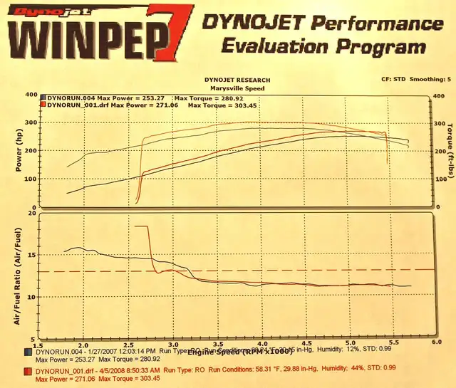

My car was originally equipped with an AOD. Last January our car club had a dyno day at Marysville Speed-n-Custom using their Dynojet. The car put down 253 rwhp and 281 rwt. During the fall of 2007 I swapped out the AOD for a T-5. Last weekend I had the car back up to MSC to see what the difference would be with the manual transmission. The only changes made to the car were a new cap and rotor and the tranny swap. New numbers were 271 rwhp and 303 rwt.
Here are the two runs overlapping each other. Red is this year and blue is last year.
After the dyno run Saturday, I swapped out the Cobra intake for a Tmoss-ported GT-40 tubular and 70mm throttle body. My club is having another dyno day a week from Saturday, so I'll have numbers for that over the Cobra then.
