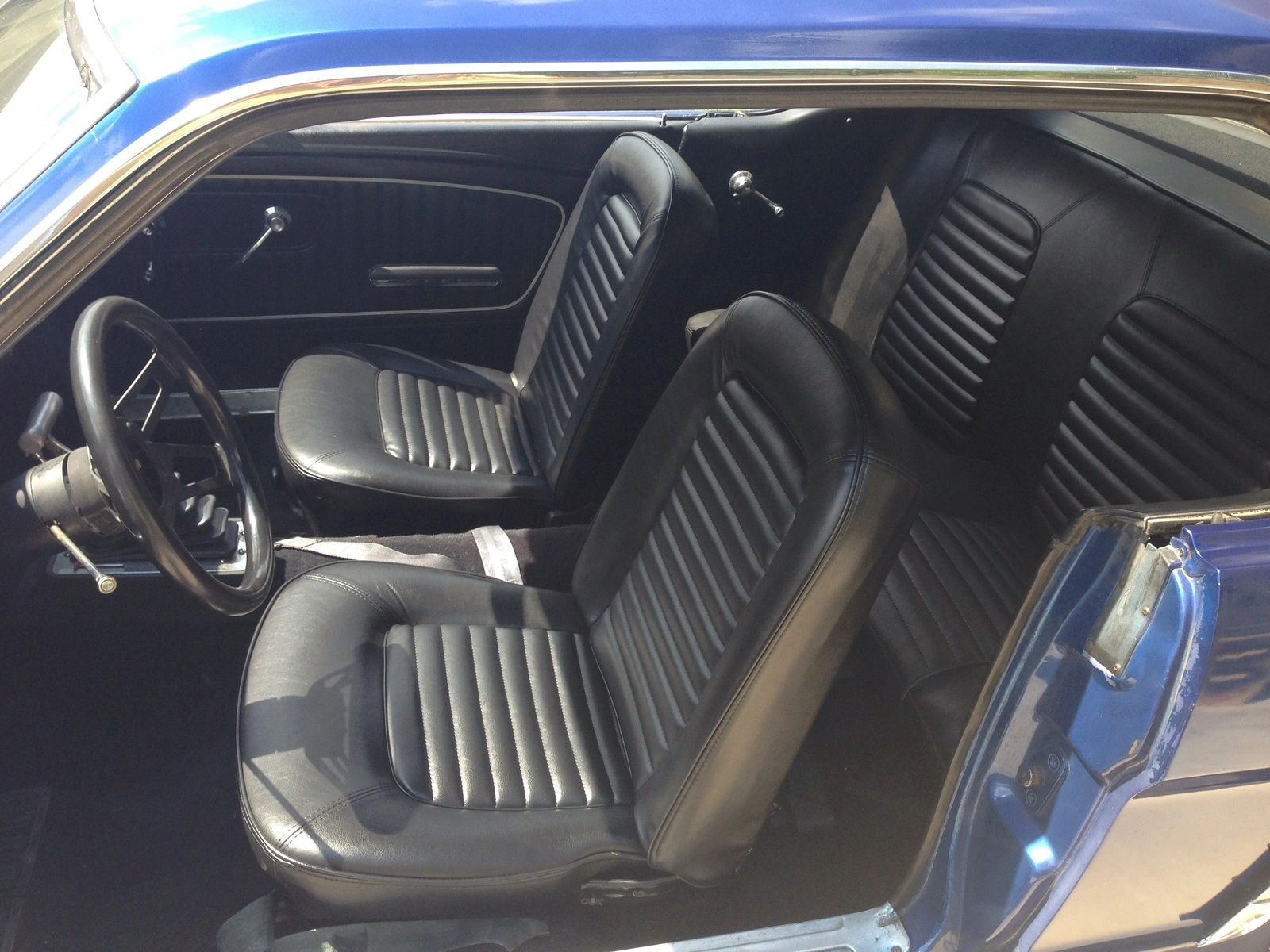

Thanks! Got it all done and seems to fit good and looks pretty good in my opinion for my first time doing it! But my question is why is it that no one makes new foam for the rear seats?
