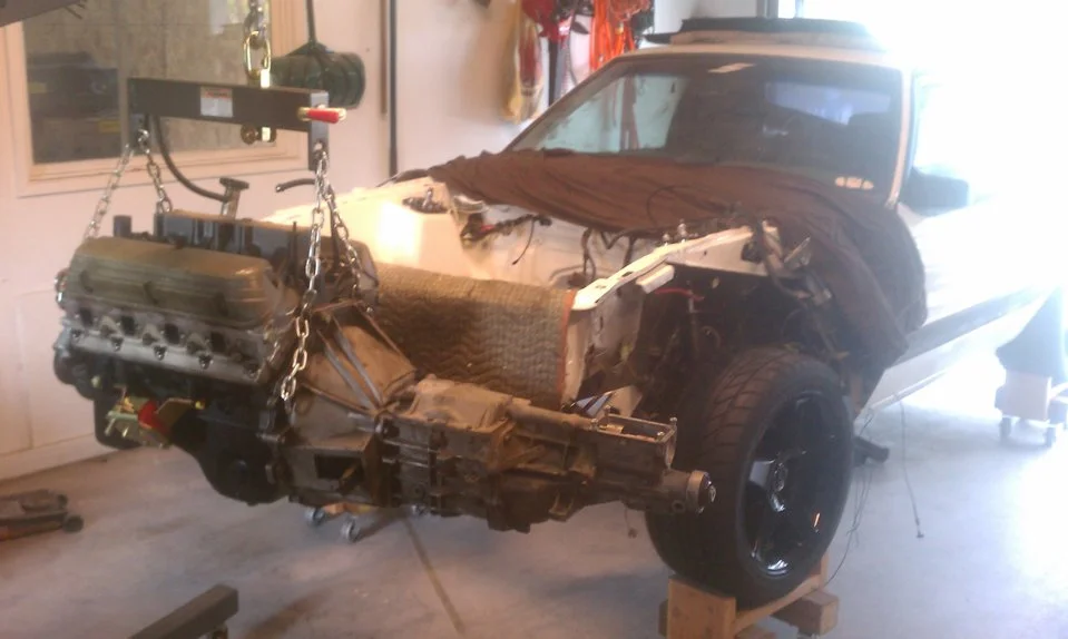

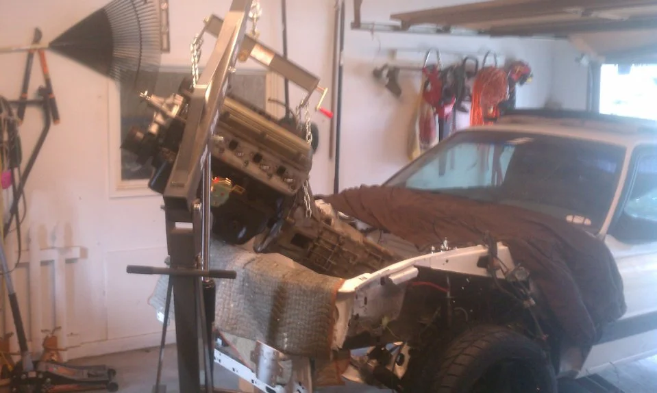

I did make a "balance bar" I call it and have it attatched to the provided brackets I was planning on attatching my electric hoist to the lift point on the trans (pas side closer to the rear) and using that to control the tilt. Trans is empty but engine is full
it went bitchen except that the front was up a tad to mucc that it just didn't clear by about 1\2 inchish or so which led to a lot of fun manipulating the whole assembly to and fro then aft and all over again several times
