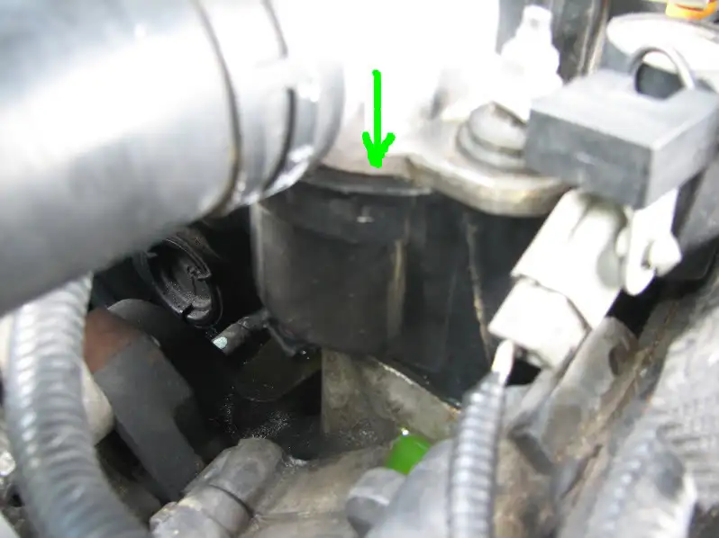

    is this a sign of my intake warping or going bad or something? i was gonna take the crossover back off and try and seal it with some permatex :shrug: any help/suggestions would be greatly appreciated..heres a pic:
    the green arrow points to where it is leaking from

  2. That's the EXACT spot that the plastic intake on my 98 GT started leaking. We couldn't see a crack either, but it was definitely leaking. I would get the motor warm, then wipe away any water or moisture on the intake at that spot, and see if you see any moisture form around that spot.

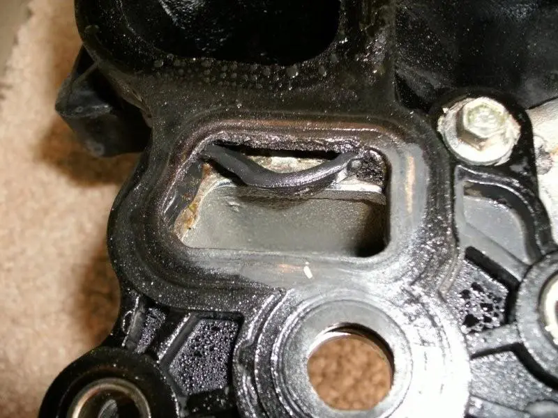

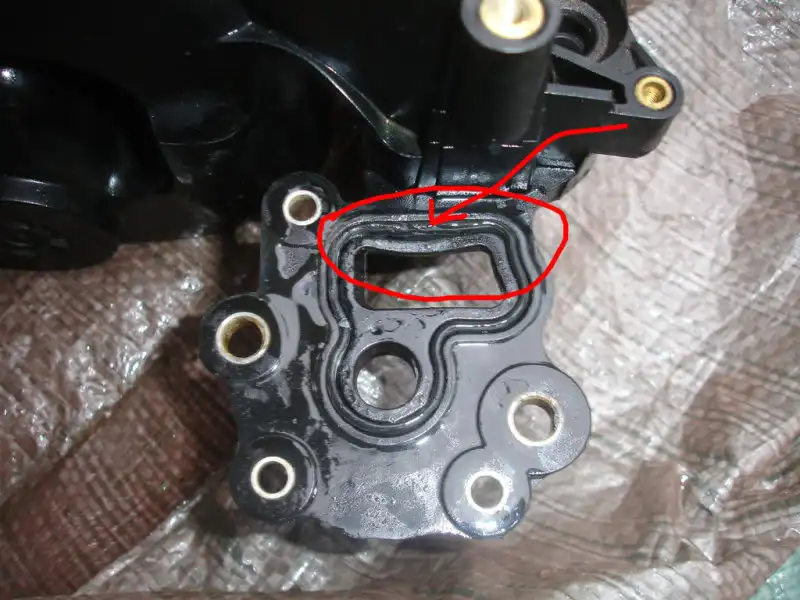

    I hate to be the one to give you the bad news, but, you will need to have your intake manifold replaced. The 1st picture below is from my sons intake, the 2nd picture is from another person from one of the forums. Both of our intakes, and hundreds of others, including you, have coolant leaks in the same exact spot, just below the thermostat housing. These two pictures were taken after the intakes were removed. They are of the bottom views of the coolant port where your leak is at. I have numerous threads posted on the matter on various Mustang Forums. If you are interested in the cause of your coolant leak, you can review all of my posts concerning these coolant leaks, or you can email me if you like at: [email protected]. Good luck, Tommy.
  5. Posted via Mobile Device i figured i was gonna be replacing it..i was just hopĂ­ng maybe it was fixable...oh well i guess ill be upgrading..thanks for the info and pics!
