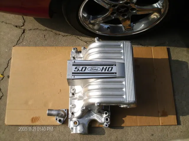

94GTCoupe 10 Year Member May 7, 2006 1,412 91 79 CA Jan 18, 2009 #5 Jan 18, 2009 #5 86-93 cover plates will fit the explorer/mountaineer intake. see. View attachment 276789 only thing is it has four screw holes,whereas the explorer/mountaineer intake only uses two.
