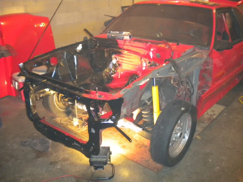

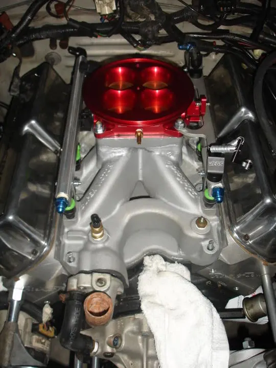

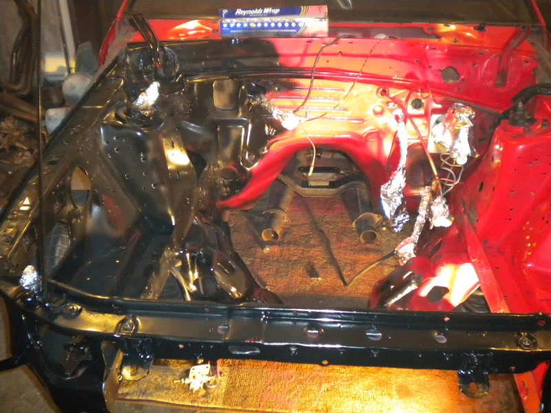

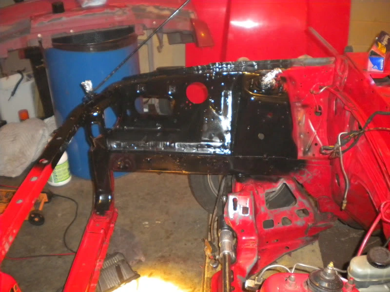

  2. SBF alluminum block! Wow there is alot going on in that engine compartment!

  5. Haha thanks guys.... it does have a lot going on but I think I finally know what it all does now. Im just the pit **** on it but its fun to work on
