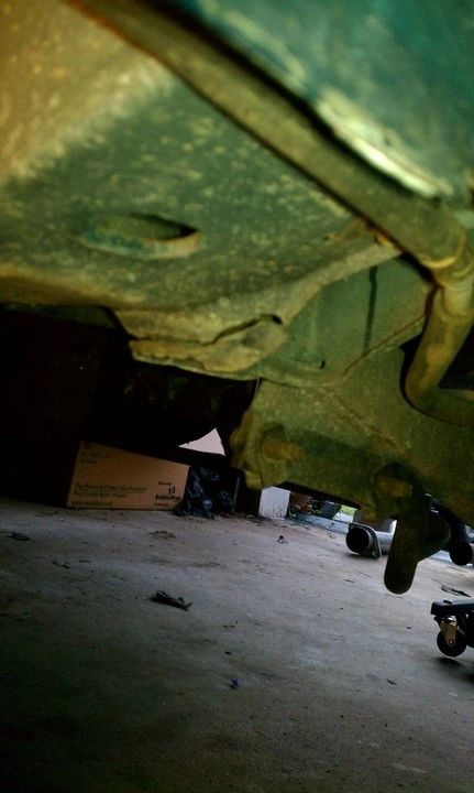

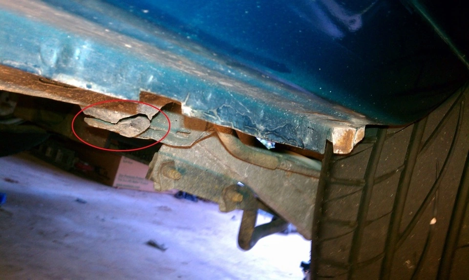

That my friend is the pretty part.. keep looking, pull the back seat and look at the torn spot welds, the cracked floor at the rear of the transmission tunnel, and shine a light around that end of the lower control arm and see how bad it REALLY is. While you are at it, check the upper attachment area.
