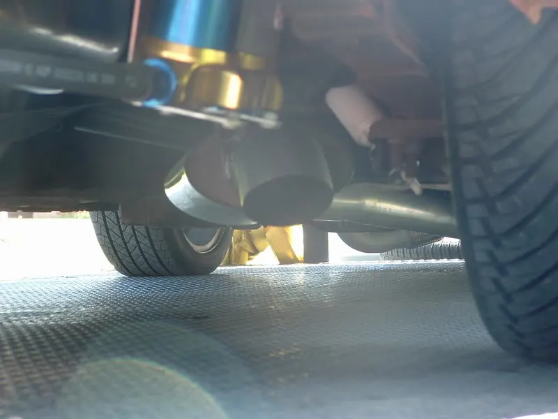

  14. Alright so the news is poor Mario became part of the HG club before he even drove or saw the car. I was taking it to a show locally and leaned onto a little bit, like I've done before, and pop.....Death smoke of the rear of the car for 200ft. No, really, 200 ft. Worst coolant consumption I've ever seen. I was feeling really bad it happened, but there was more than one contributing factor here. The gaskets and stock head bolts. Then after we pulled the heads, found this. Flat top pistons in a stroker motor equals high CR. 10.37-1 actually. The machine shop said they would fix it. There was confusion on whether the heads were to be ported. The combustion chambers where to be opened up, and a flat top would have been good for about 9.3. Thing is she never got ported. She now has head studs, and SCE gaskets. We'll keep the boost low and a safe tune with a snow kit and call it a day.
    While in the saw rtv on the HG's which is a no no. It was blocking all the steam holes except for the one that blew. And by the looks off it was probably the same.

    ( Amazing how cooling works when hole aren't blocked by RTV eh ? :bang: )
