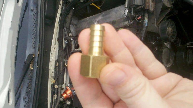

    I see you already found a brass fitting collar to go in the lower to plug it. If those lines fall through and/or you don't feel like messing with those heater tubes, you can very cheaply put together a solution with brass fittings and some heater hose.

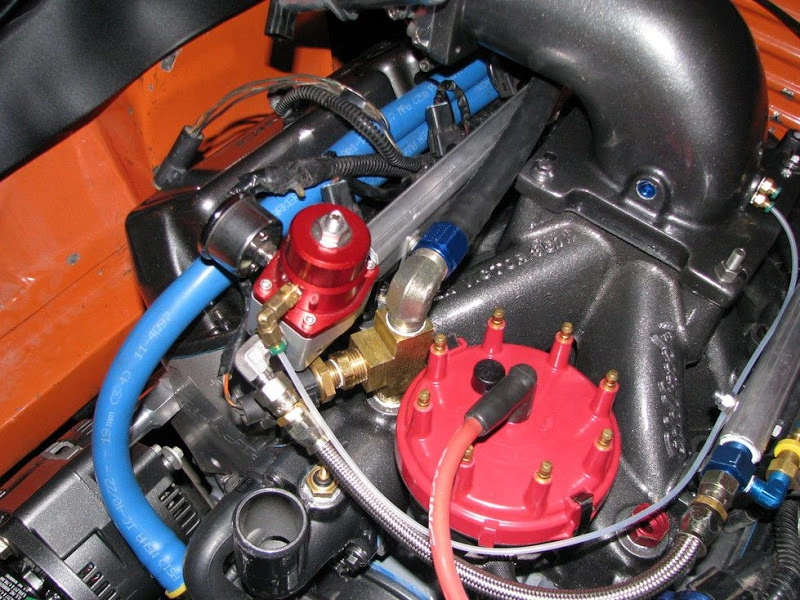

    I ran in to a problem where the stock lines wouldn't fit my intake, and someone else posted a picture of their solution which I'll share here. They used a T fitting to provide a spot for the ECT as well as allow a run to the heater core.

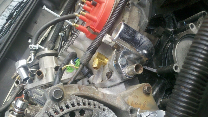

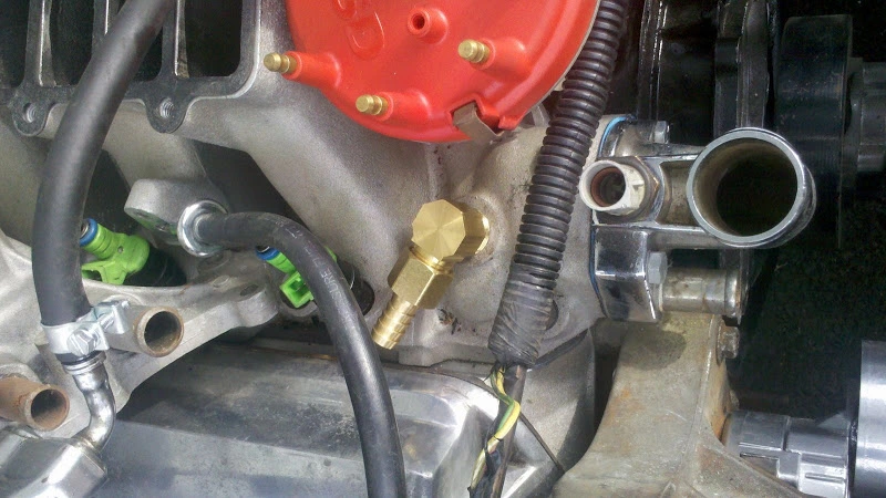

    My solution is slightly different because my aftermarket water neck has a provision for the ECT, so I just used an elbow and a barbed fitting.
    elbow
    barbed hose fitting
    mocked up

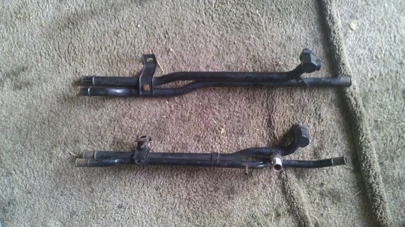

    Here are what the heater lines look like, you can see the bracket on the back where they bolt to the lower intake manifold. SN95 style is on top, foxbody style is on the bottom. They place the ECT in different locations. Please excuse the mangled foxbody bracket.
  2. Your solution is much better than the first one. The first one positions the sensor too far away from the water flow. The sensor must penetrate into a flowing passage of water. If it is recessed into an eleborate collection of T's and adapters like the first guy has, the water will stagnate around the sensor, and it won't get an accurate reading.
