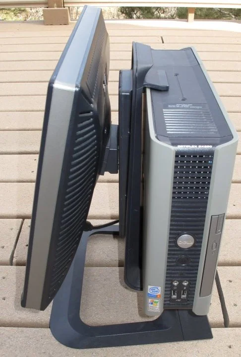

    FYI this particular model computer has major issues with the capacitors.The capacitors are defective themselves. You can look it up on google its a know dell issue I work for a school district and we have had to replace at least over 50 computers of this model motherboards due to boldging capacitors you can replace the capacitors when they start to go the computer itself will start to exibit weird behavior like shutting itself off or an amber light when trying to turn it on
    #471
  12. KamiKaziDK
    KamiKaziDK Member
    Joined:
    May 16, 2005
    Messages:
    560
    Likes Received:
    Trophy Points:
    17
    Location:
    Mesa, Az
    If it's still running now, it's probably ok for the most part....and it was $30, I'm sure she's not too incredibly worried about it. And bulging capacitors are just from being overpowered, it's like if you plug two 9 volt batteries into each other.

    yep... my hand is all cut up from tearing the case apart last night and replacing the 3 capacitors that were leaking, everything went well and none of the other capacitors seemed to be swollen or any visible signs of problems :)
    and honestly, I bought it "as-is" for $30 and assumed it had bad capacitors and wouldn't work, but there doesn't seem to be any problem with it whatsoever. The p4 it came with was the fastest processor for this model which is nice too (3.4ghz with hyperthreading) and it's the 84TDP watt one instead of the 115w, supposedly they idle @ 20w and it shouldn't really need all of the processor very often I'd imagine, other than on bootup which is fine with me. Bootup time from power to desktop was about 15 seconds, and I think I can improve that time also. Not sure if hibernate is even faster lol. Using a 750gb 7200 rpm drive, would like an SSD drive but can't really compete with a 750gb in that manner... and the 2nd drive would have to be external as there's not enough room on the inside of this case, and no more expansion methods other than USB.
    Sorry for babbling, but I think you all know I do the computer thing :)
    #473
  14. fordtech28
    fordtech28 Member
    Joined:
    May 12, 2006
    Messages:
    312
    Likes Received:
    Trophy Points:
    17
    Location:
    Riverside Cali.
    Very impressed we replaced some on ours but it came to the point that it wasnt worth it in some cases like 12 caps being blown its time consuming .If you replaced the main ones you should have a good machine for a while since the caps where the main issue the machine is a great machine when it works.:nice:
