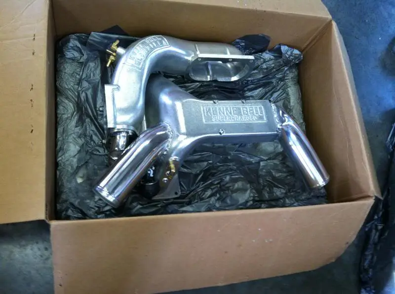

    Hi I am making the modification to the KB manifolds. I would need your and 4 weeks to complete the fabrication and welding. As far as the intercooler pipe goes that has to be fitted while on the car and would be best left to you. I can help with choosing the pipe angles.
    Here is an example of the manifolds with a compact bypass provision that I have designed. I offer this for $1000.

    How tough do you think it would be to find flexible piping to run back and forth to the intercooler with?

    Hi I only do the fabrication and welding to the intake like seen in the picture above. So you would have to send me you kb manifolds and I do the rest. The pipe routing is not hard and can be done locally or by you all the pipe bends are in my instructions from the beginning of the thread.

    You should only use alum pipe, even the elbows need to be supported because it sees vacuum that will collapse a none ridged or supported silicone elbow like a 45 degree. Making the pipe fit is not hard and I could help you with that.
