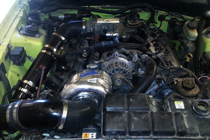

    Getting dyno-tune this week. Lets get some guesses as to results.
    Built motor (9.5:1)
    Stage 3 heads
    D1sc @ 16lbs
    91 pump fuel
    full o/r exhaust
    stock cams :(
    Sorry for the underhood filth. Dust storms are frequent here and later washed.
