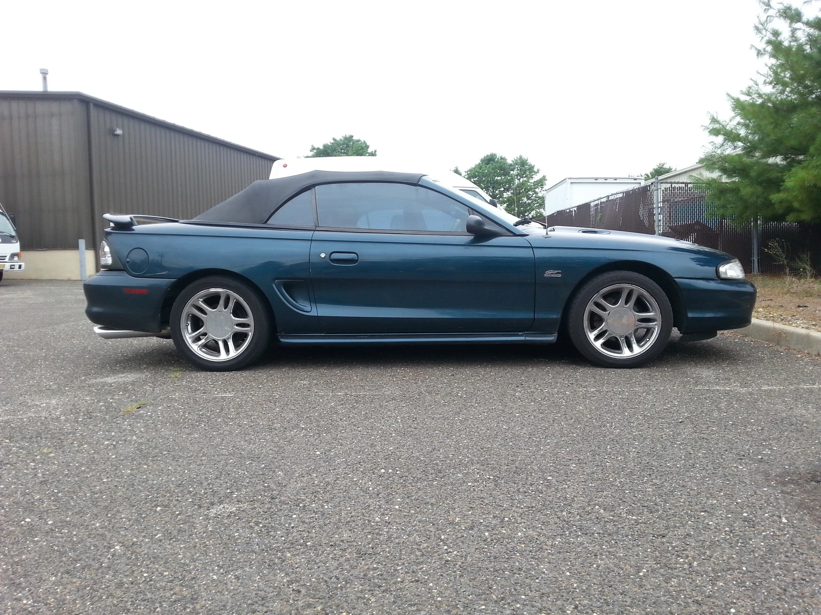

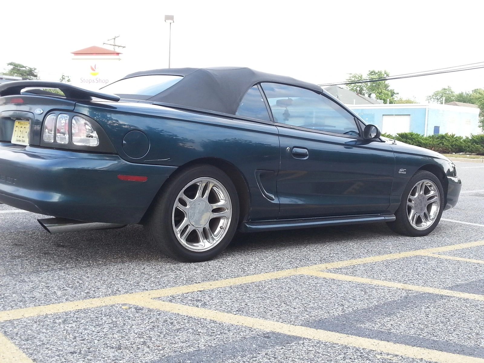

  19. Also how much of a drop do you think this car has I know its lowered but how much? Any guesses?
