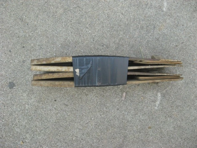

    Just a tip: cutting leafs a great, free way to tune your spring rate, but you really, really need to grind a taper into the leafs so they don't gouge each other. Also, look for rolls of poly plastic sold at street rod chassis places that's designed to go in between leafs to help them slide when assembled. It makes a huge difference and is cheap.

    I was getting ready to do it the original way but this way looks easier. It appears that you cut the same amout off of each leaf. How much did you cut to get the
    3/4" drop? Is this alright to do for a street car? Thanks

    Each piece is 8.5" long and yes, it can be done to a street car. Both of the cars I've done it too are street cars.

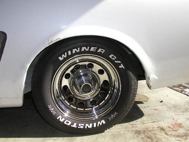

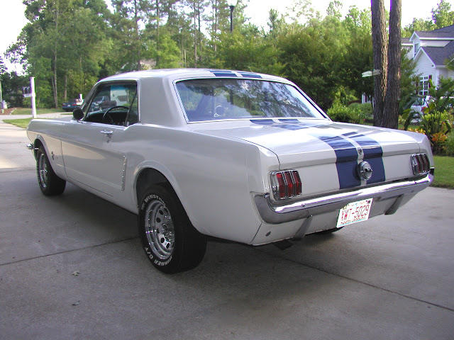

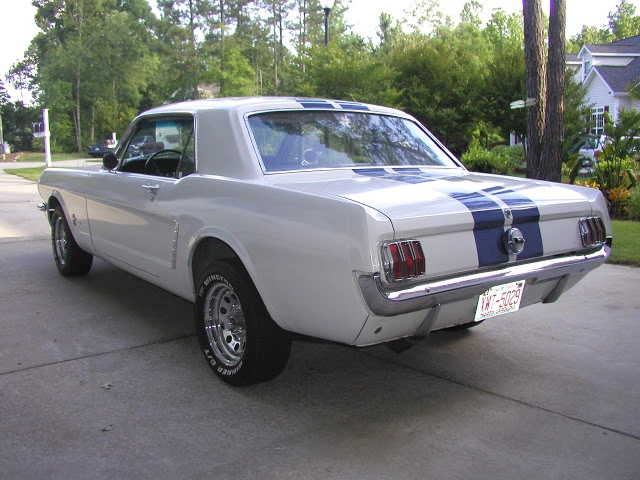

    Thanks for the pics. This thread is almost 4 years old and still getting attention. This is one of my favorite mods.
    Before
    [IMG]
    After
    [IMG]
