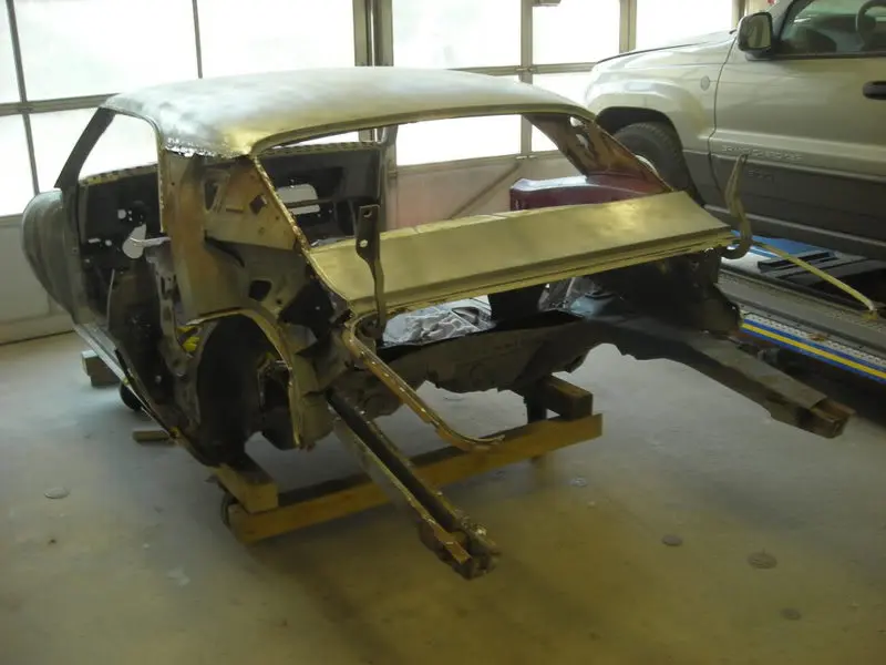

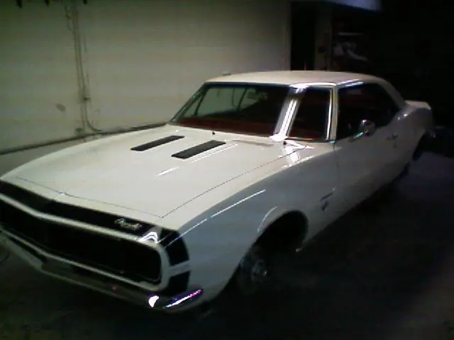

  6. Your not the only one that does body work for a living pal. I've been doin this stuff for 6 years and have a degree in collision repair technologies. Single stage is just as good as base clear. Some people prefer b/c over single stage. Regardless of the two, you should be able to wet sand and buff them the same way. You can get the same film thickness as clear coat with single stage. With single stage, the clear is in the color. Tell me, whats your position in this shop? Pretty much EVERYONE on these forums know that the best way to prep a car for paint is to strip everything off. Check out this 67 Camaro I worked on at the last shop I worked at. I did everything from fitting the quarters to straightening the doors to wet sanding it for paint to to wet sanding and buffing it............................
    and the finished product (minus wheels)
    This car was painted peice by peice with nothing on it.

  7. Damn, that Camaro really needed the whole back half!!! Great job man. Those are my favorite Camaros.

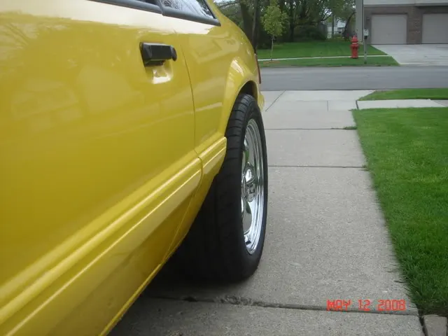

    And single stage wetsands and rubs great. I used the same 100, 1500, and 2000 method on my yellow notch with the single stage. You can get it flatter than bc/cc because you are wetsanding the actual surface or the material. In bc/cc you can't wetsand your bc once the clear is layed, so you can only get it so good. Single stage is harder too. I used an aggresive pad and aggresive compound and it didn't harm the finish, it just improved it. I used the same pad and compound on a bc/cc job and it burned the clear a little bit. Luckly I had a lot of clear where I could wetsand the burned area, and it leveled out just fine. I then switched to a Meguiars Finessing Pad and a lighter compound and it was fine.

    Here is a pic of my crappy single stage paint job I wetsanded the **** out of.

  18. bc/cc isn't the only way to go with black, but while wheeling out my yellow coupe, I was noticing some wheel marks that would drive me insane if the car was black. I have never gotten wheel marks like that in black bc/cc cars. I just think because you can get single stage so flat, you would go crazy trying to get everything out of black, because it shows so much of everything.
