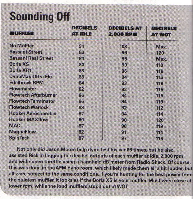

    This is from an old 5.0 mag.

  15. That graph is with other parts stock,as far as stock h and everything then macs are not that loud at all.but with no cats they sound amazing and even better with and x pipe matted up to them.i know when i put my cats back on my car was pretty quiet.

  18. The car in the graph was a 6750 rpm screamer:D, and it was done in an enclosed area so it is going to be on the loud side. But the test was controlled, same car, same room, same conditions; and like I said earlier the stock '85 heads aren't exactly the highest flowing head out there.
