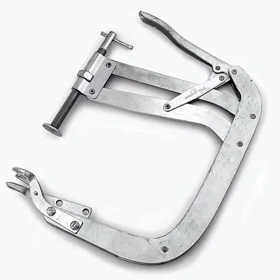

  5. I have the heads off. When compressing the spring, it's pulling the bottom of the spring up out of the spring seat.
    It's not pushing the spring down so that the keeper is exposed.
    After compressing the spring, do i knock on the top of the tool to push the spring assembly down?
    It's a tool like this:
  6. With that tool you have to crank it pretty far. It came out of the seat on me. Crank it and push the whole thing down into the seat. If I remember right, look at the valve on the bottom of the head, it should be open about 1/4 - 3/8". I just tapped the bottom of the valve with a plastic hammer. The wedges let go. I think used a magnet to pick the wedges from around the stem.
  7. Use the two black bottom fingers and go as close to the bottom of the spring as you can get. I would hook them on and kind of twist it down the spring... It would have been nicer with that tool if they made those black fingers even instead of having one longer than the other.
  8. Well I think the problem is that the TFS springs are a double spring. This tool only compresses the outer one. It looks like the inner spring is still pushing against the cap and retainer.
    I probably need a different tool... thoughts?
  9. I don't understand why you are taking apart brand new heads. I'd be shipping them back to TFS and have them look at them. Once you disassemble them, you have no recourse. Personally I don't like that type of spring compressor. I prefer this C clamp type.... found it much easier....
    However, here is a video on how to properly use the type you have
  10. Yeah you're gonna have to use a c type, or cylinder head off type. Unless you can get the tool to grab both springs. Bummer. I didn't know you had double springs.

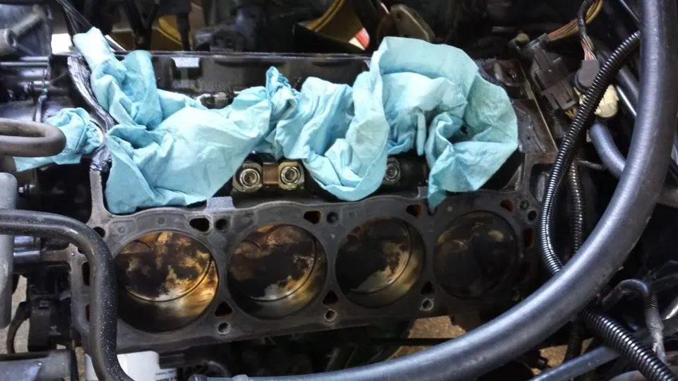

    None of them are burned but 1 cylinder's intake valve looked much darker than the others.
    Also my pistons looked like there was a lot of carbon on them...

    The issue is hard to see in the video but it's there... I just want to have everything in the heads checked so that i 20130907_150220.jpg can know that there is no problem there.
