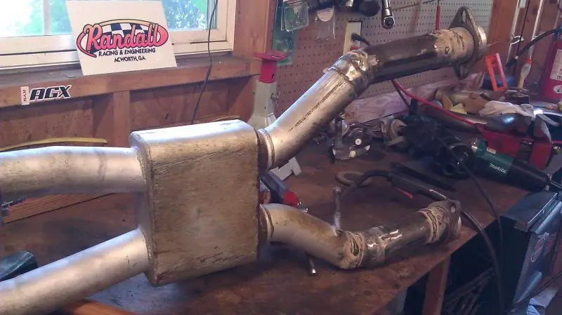

    I assume this is a manual foxbody header from BBK? That is what I run on my SN Mustang. Those BBK 1 and 3/4 headers fit really well. They do come in very tight to the transmission on the driver's side. More so then the other brands. The header also angles towards the transmission with a funny angle. I ended up having to hack of the inlet tubes to my ProChamber and rebuilding them from scratch. No amount of bending was going to make it work with that funny angle.
    Kurt
  8. Well i guess even us older stangnetters can still learn something new! :confused:

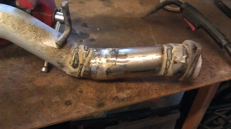

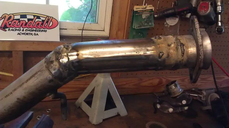

  9. This is what I had to do. I used prebent mandrel sections from Jegs. I always sleeve weld for durability and longevity.
    You can see the funny angle I had to put in on the driver's side.
    Kurt
