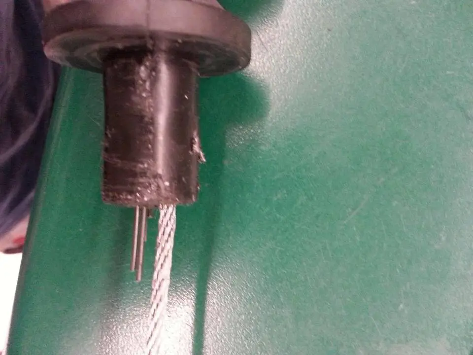

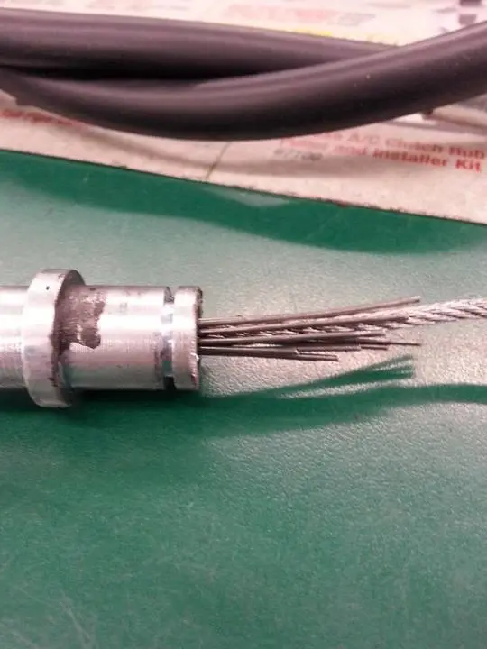

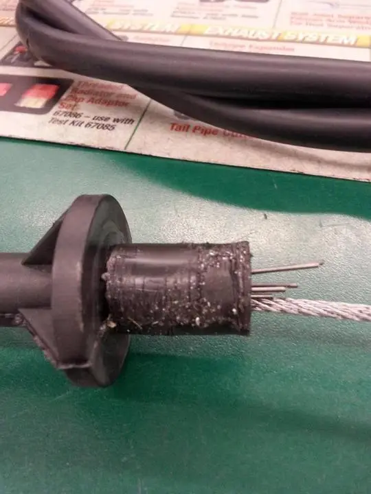

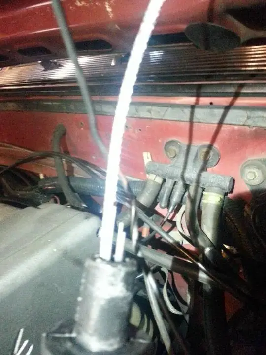

  8. Ok, so I have the routing right. But it's failing in a different way. The actual cable is fine. If you're not familiar with how the cable is assembled, it is a steel core (which is the actual cable), a plastic "sleeve" that the cable slides in, a stiffer outer stranded steel shell, and then the plastic out side. What is happening with my cable is the outer steel core is pushing through the plastic bit at the end and the metal bit at the other end. I'm so lost on wtf is causing this.
    If you look next to the cable you can see the shell piece pushing through.
    Any ideas?

  10. If its your DD get the adjustable cable and get on the road. Adjustable cables arent popular but It's worth a try. I can attest its the only combo that worked for me. That's after trying a single, double and triple hook quad, fwa and cables from every major parts store near me. They all got eaten up like in your pic.
  11. I've got a Steeda adjustable cable on mine...and zero issues. It's a little pricier than some of the others, but it's as good as you're going to get in an adjustable cable. I'm told the Maximum Motorsports cable is a nice replacement as well.

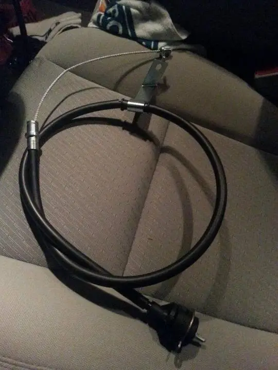

  12. Clutch4_zpsc1c13be7.jpg Clutch3_zps818c3546.jpg Clutch2_zpsc0933ac4.jpg Clutch1_zps7fb2db01.jpg
    So there's what the old one looked like. I installed the new one and all is well for now. Has anybody seen this happen? and is an adjustable my only option to prevent this in the future?
  13. It's being cocked to one side... u have wear northern sheaths that go into the fwa... cable is breaking there for that reason
