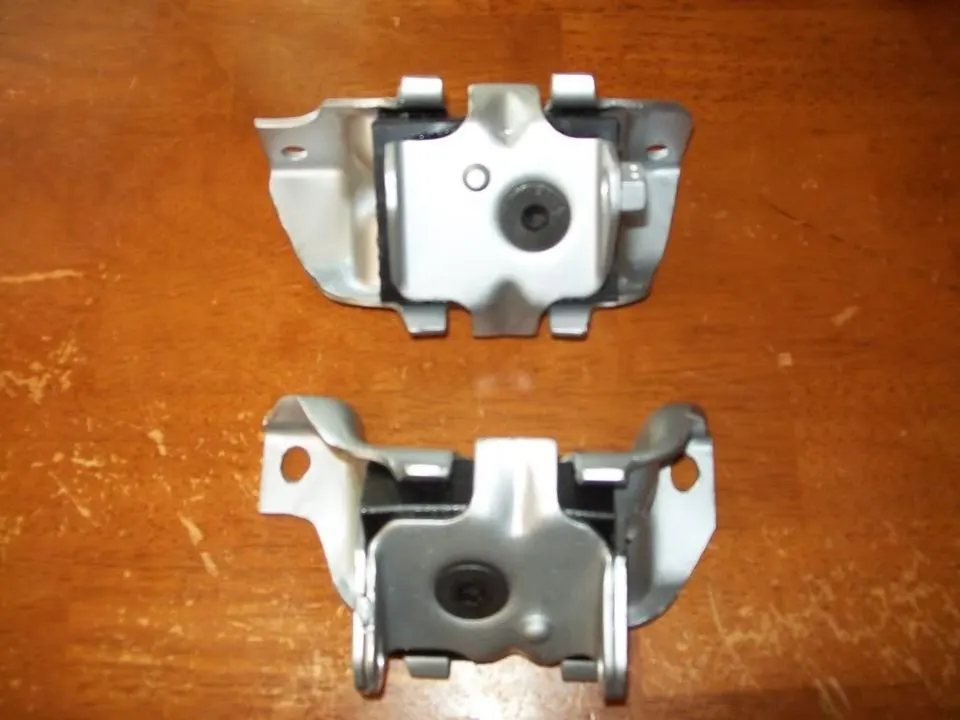

  6. Yes, we've used Brett's rebuild kits on several of the II's to come through the shop (including both the Handler and Angie's Yellow King), and they are a BIG improvement over the originals (and yes, a pair of II mounts even held together by nothing but the rivets, plus one of Brett's kits and a bit of time, will get you a good set of V8 mounts ready to bolt up)
  7. motormounts001.jpg here is a set done and ready for abuse

  8. Cool idea I used to tear apart a set of mounts ever 6 months with a wild shift kit my quick easy solution was new mounts and wrap a chain thru the hollow and back to the mounting bolt, motor still sits on rubber to cush vibration but wide open it hangs onto chain, never broke another mount after that mod
