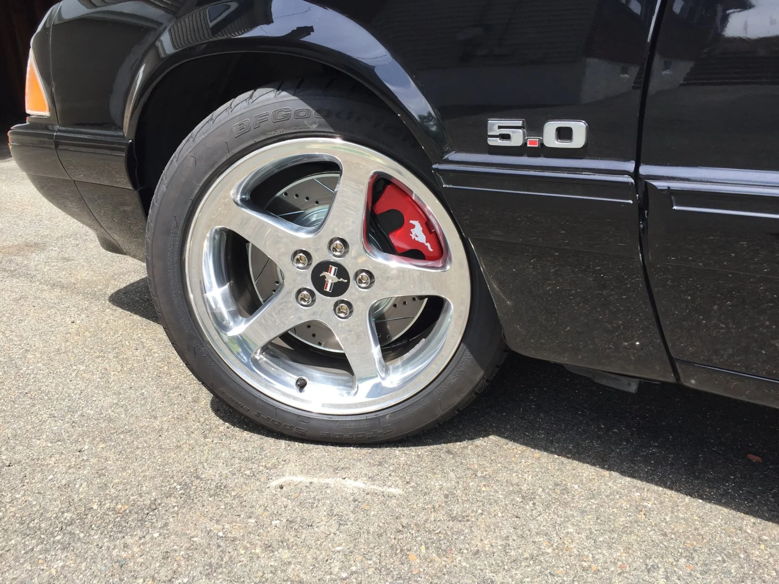

    Picked up some 03/04 Mach 1 springs. Thought they were bullitt springs but after running the p/n they are Mach springs. So they won't drop about 1/4" as much as the bullitt springs. I HATE my FMS C springs. It's not so much the ride, as it is the height. They slammed my car and there is little suspension travel and the nose is just too low. I'd rather have a comfortable ride and enjoy the car than for it to look sweet but ride like ass. So these will be going in shortly. I have adjustable arms in the rear, but I am thinking of not running isolators up front just to get a tiny bit more drop and then even it up with the adjustable arms out back. Anyone have comments about not running isolators just up front? Concerned about NVH?? but then again it is a 22-year old fox. :shrug:

  11. I actually like the stance you have now. My c springs slam the front too much. Fender lip is about even with top of tire. I hope the Mach springs pick it up a little.
    The adjustable rear mm arms are awesome. I can adjust about 2-3 of rear height with them.

  12. Okay. Got around to putting the Mach 1 front springs in. What a PITA!!
    None of the damn spring compressors I bought or rented worked. The c springs I had were right on the edge of not requiring a compressor, but the machs were 1 inch taller.
    In the end, after much swearing and trying to get the compressors to work....I used a method I swore I'd never use....I used hose clamps. 10 clamps around and just went around slowly tightening it up. Got just enough squeeze to fit it in the perch. I chose to install with no isos up front just to take It down a tad. I spoke with a number of people who removed isos and notice no difference in ride quality, so I choose to go that route.
    Anyway, I still don't recommend the hose clamp method and prob would never tell someone to do it....but after swearing for 3 hours, it did the job in 10 mins.
