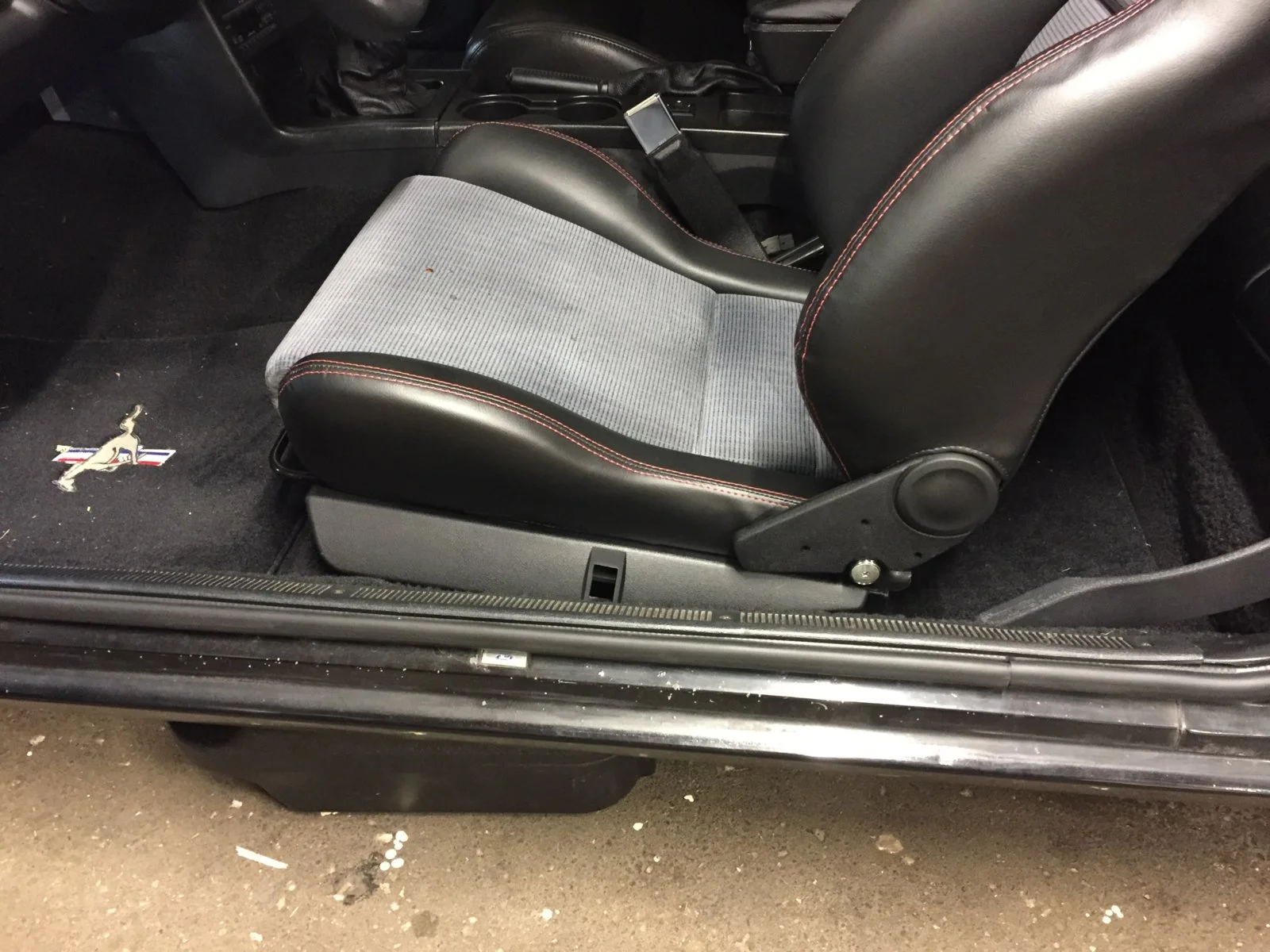

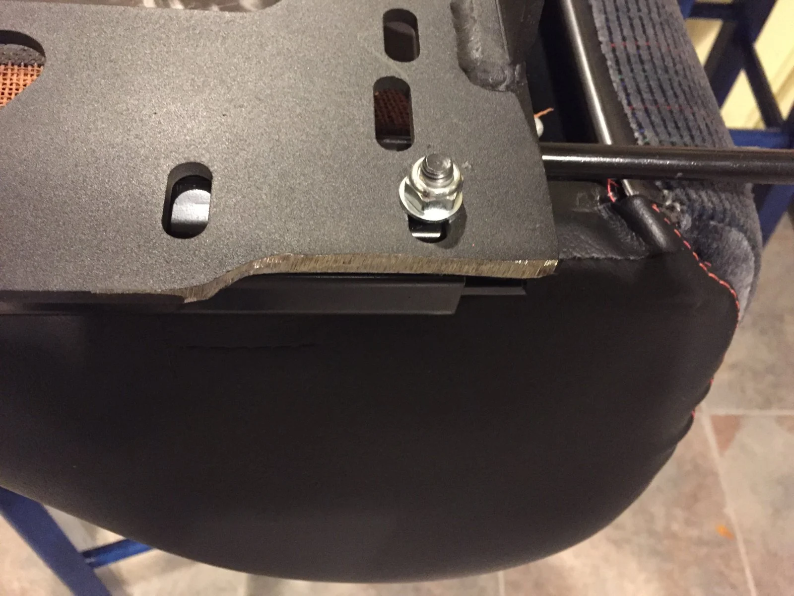

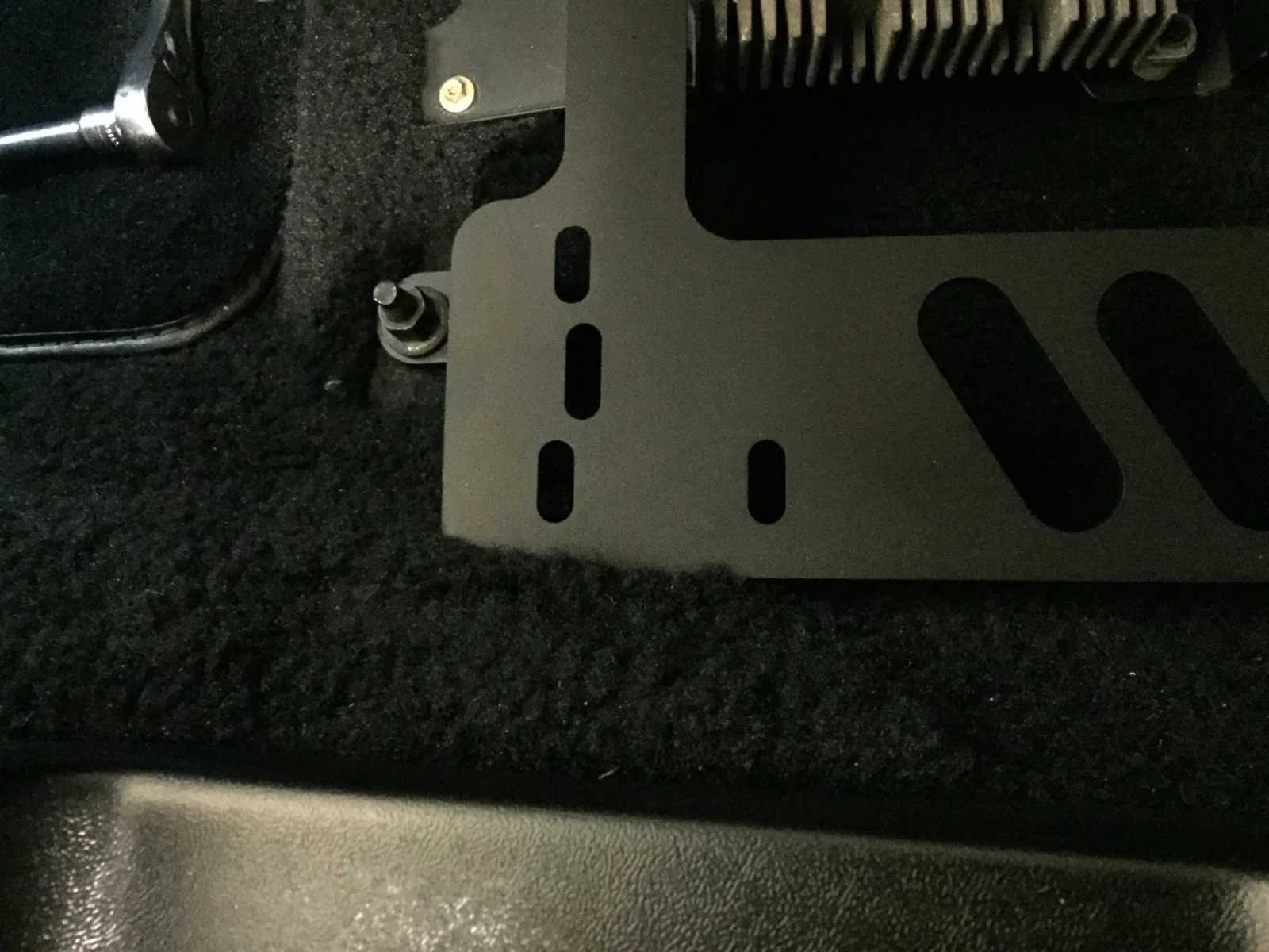

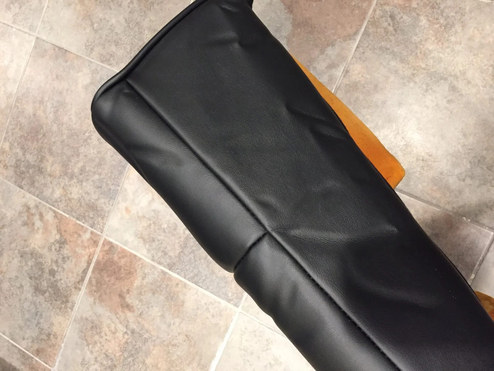

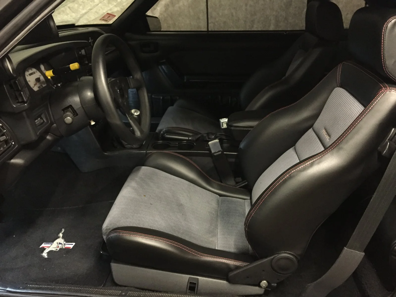

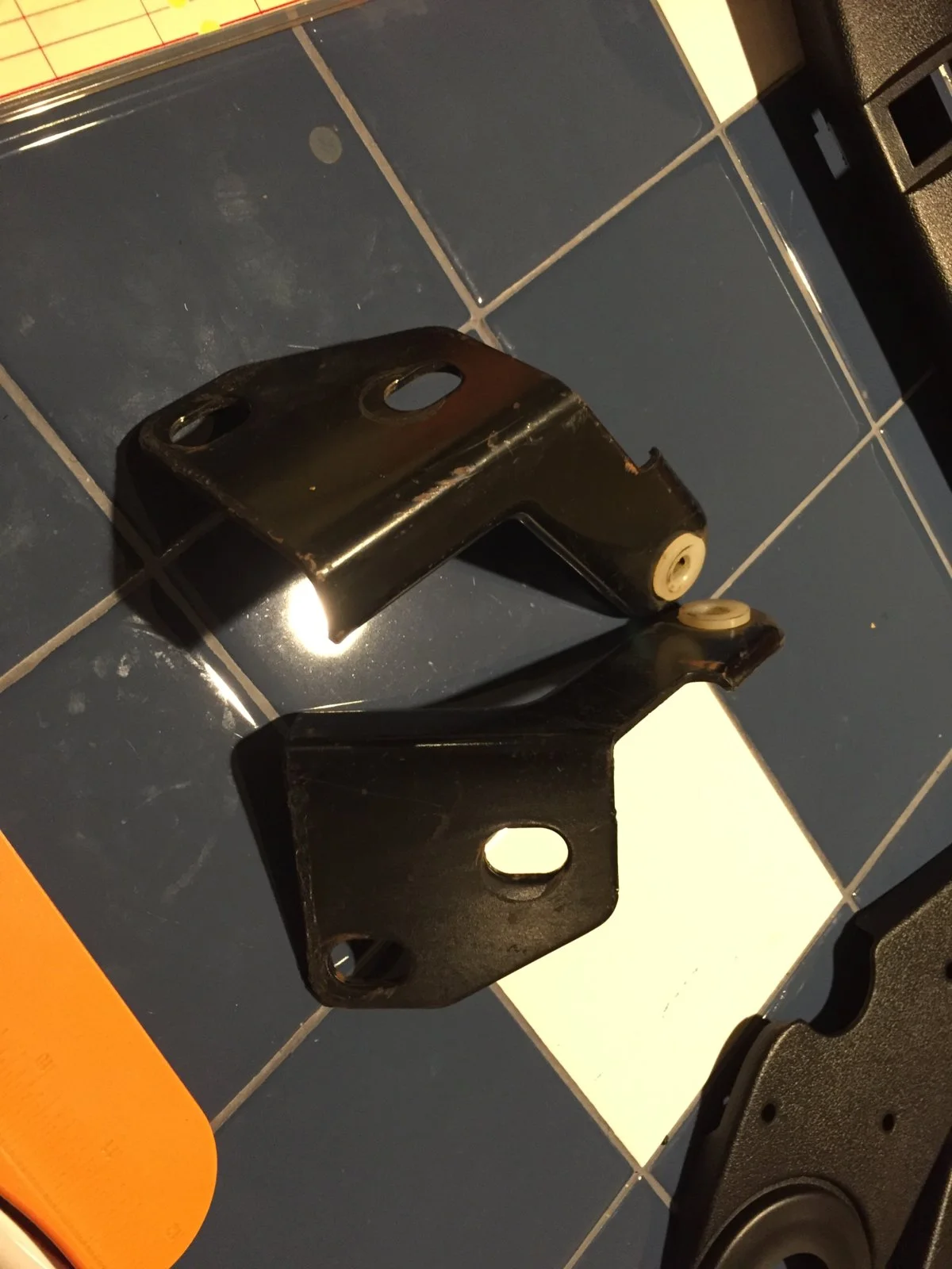

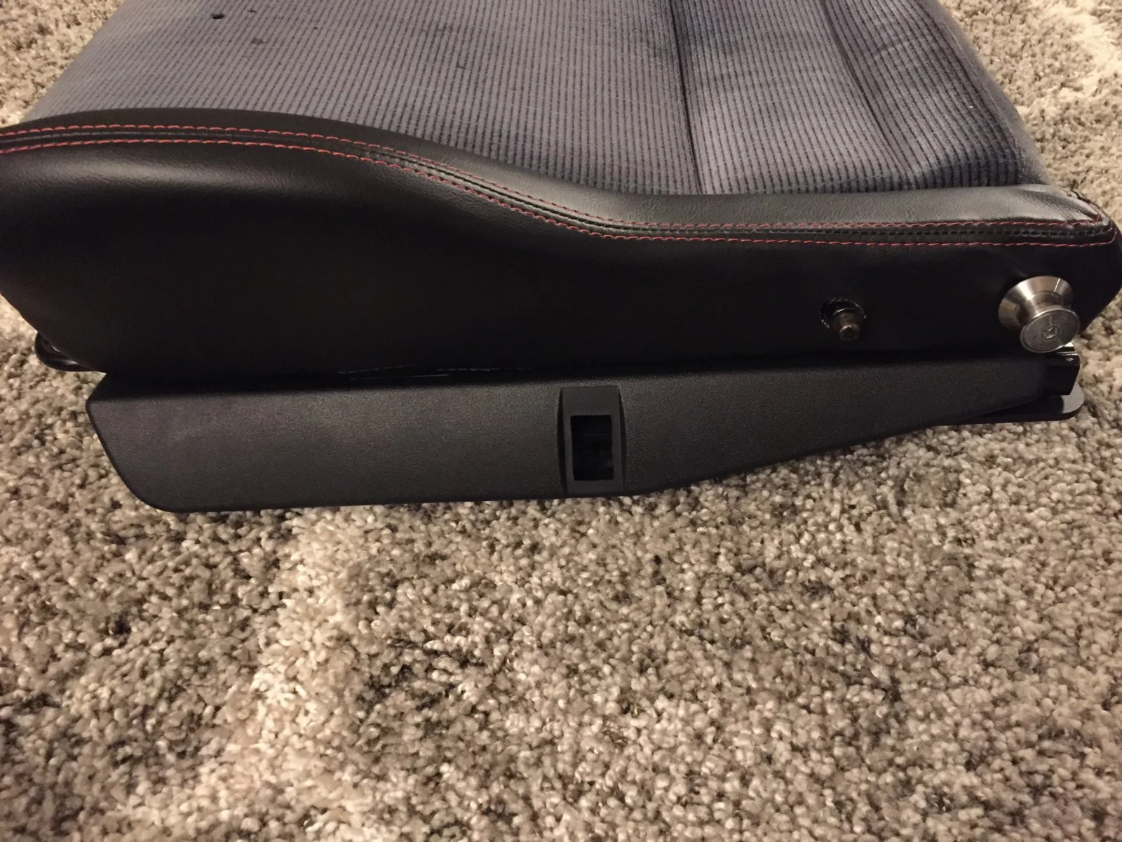

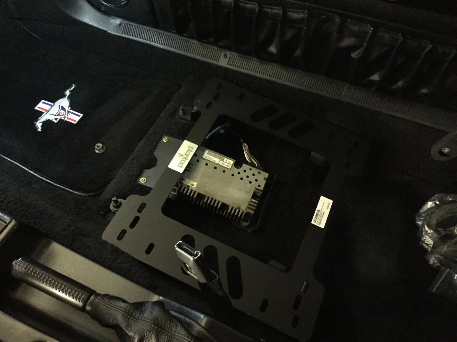

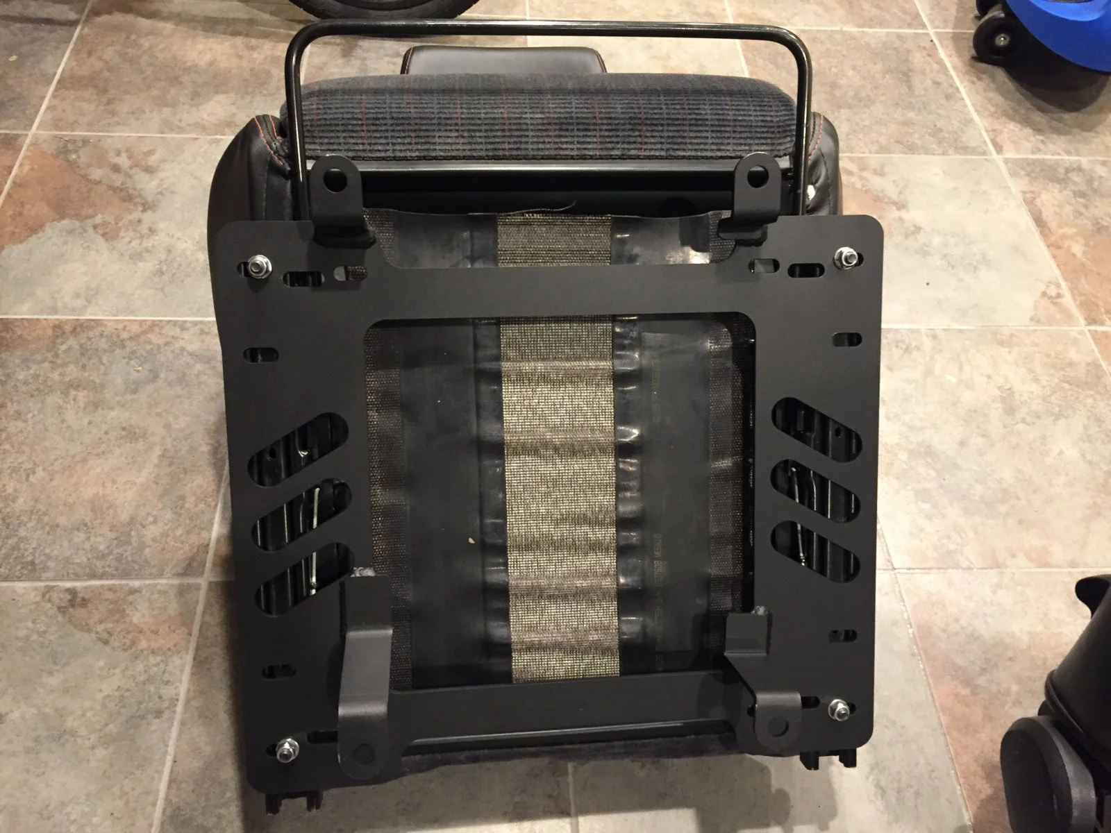

Bolted the seat mount on a seat. Everything lined up nicely. Tried to fit the seat skirt on, but since it's an oem part in a non-oem application I will need to trim slightly.
In the meantime.

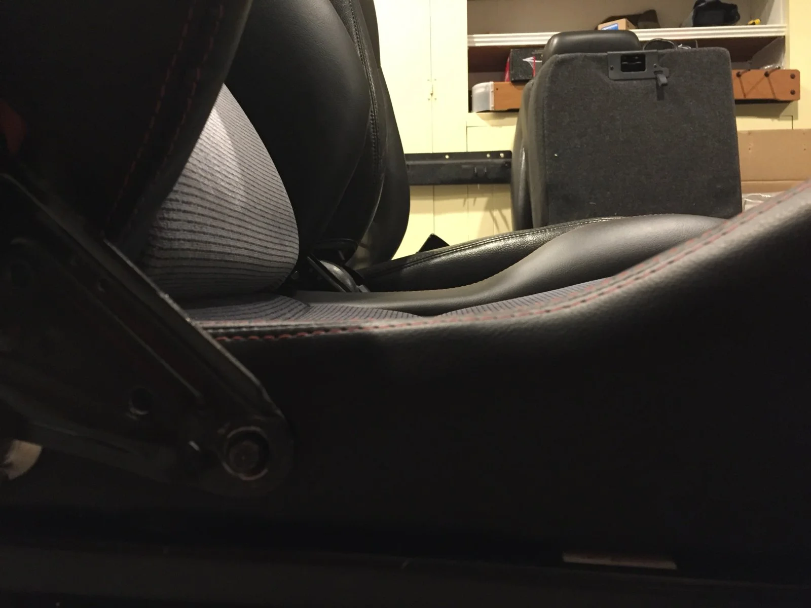

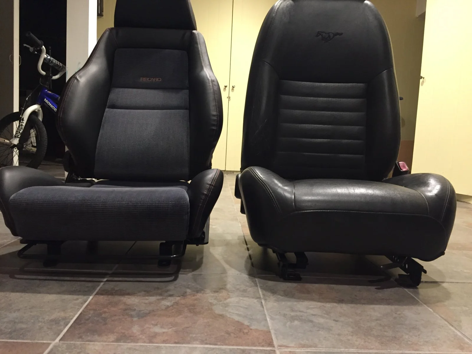

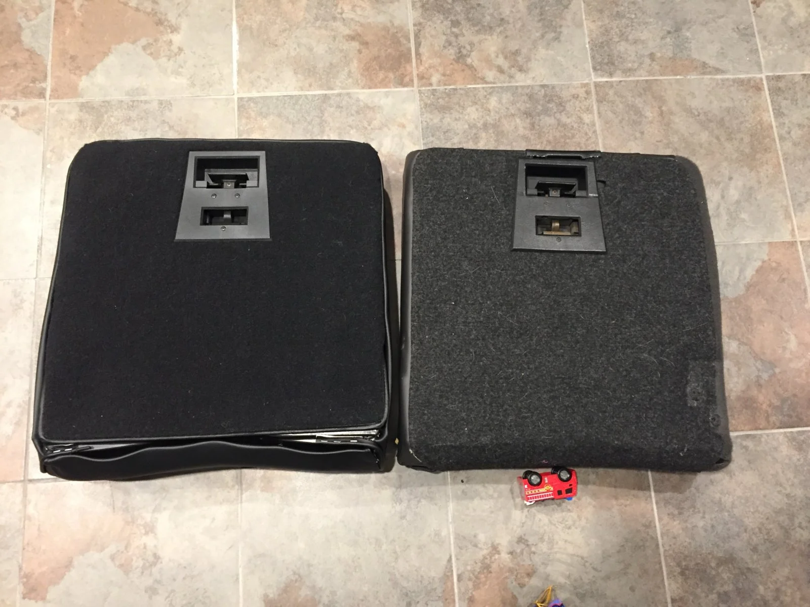

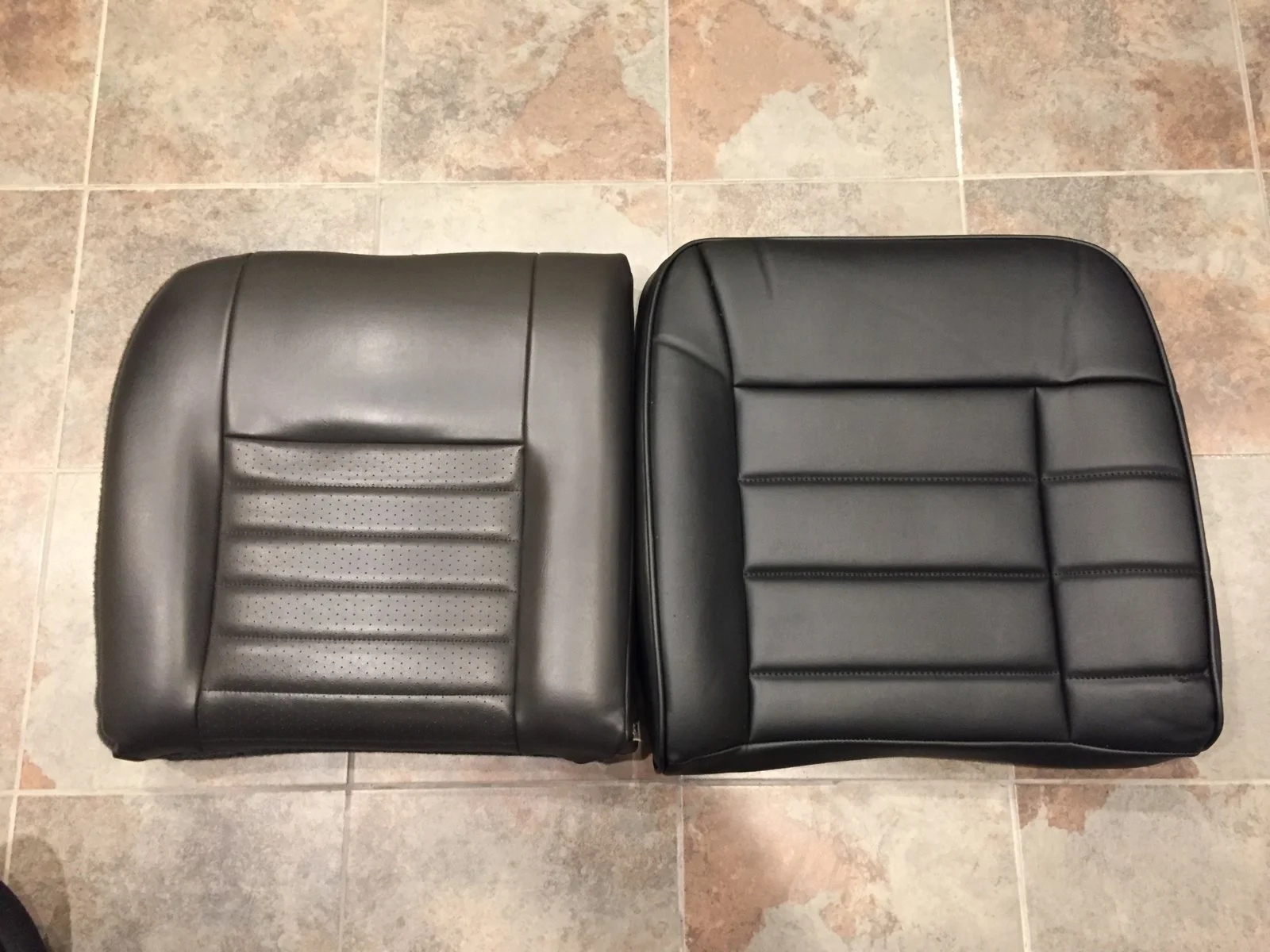

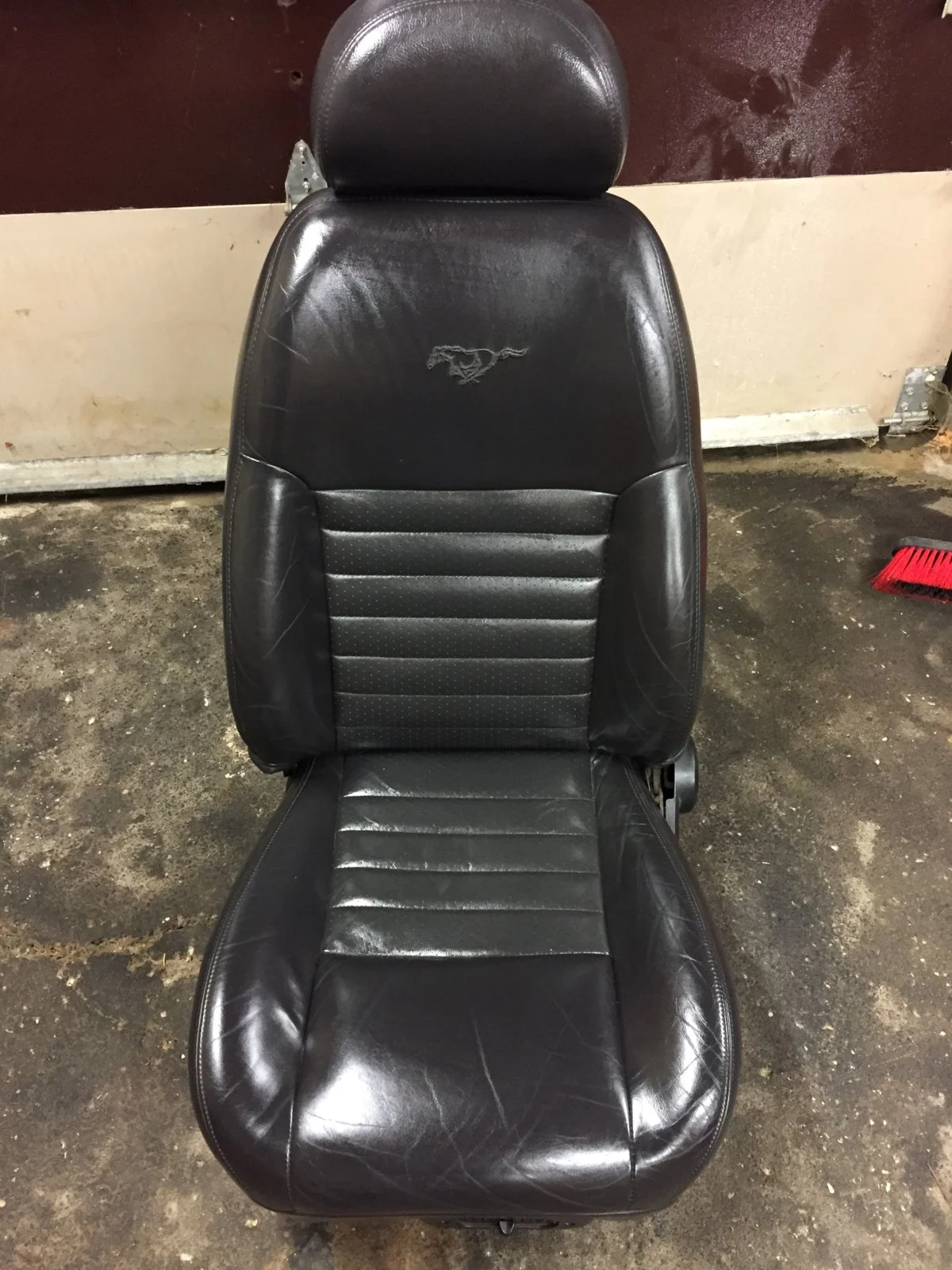

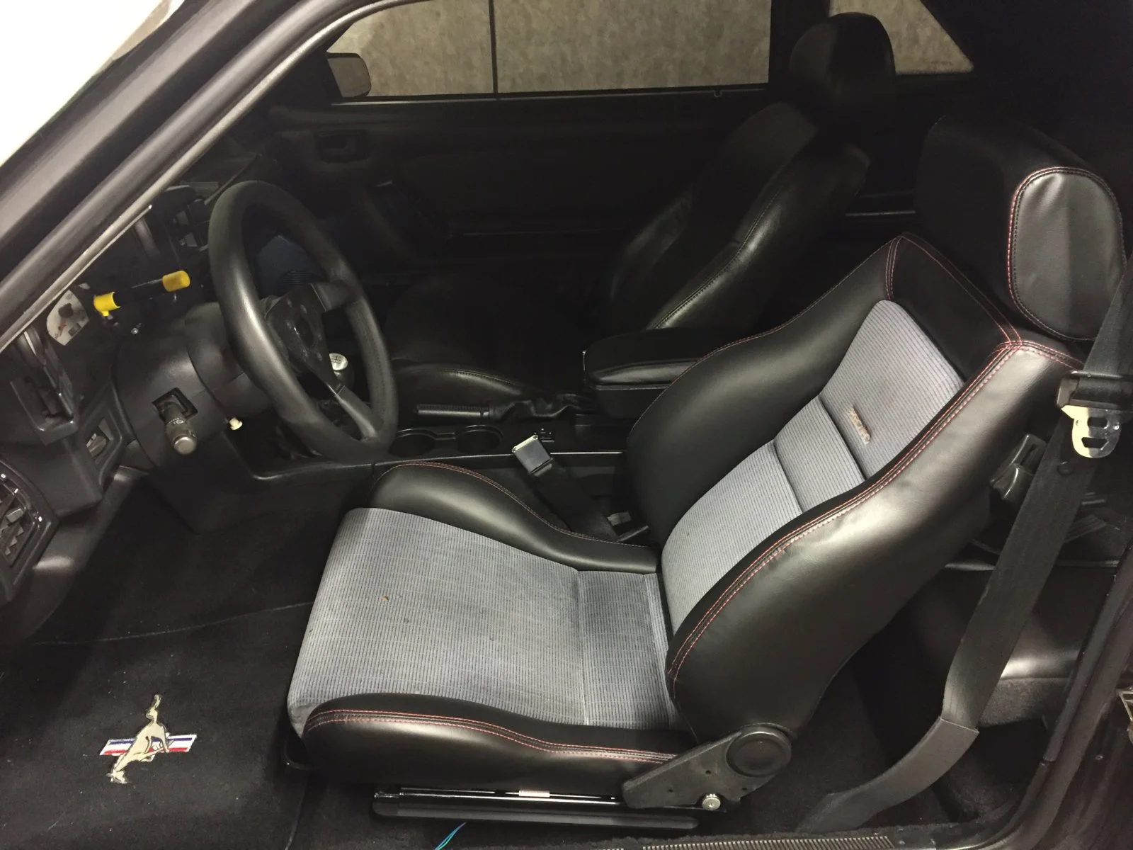

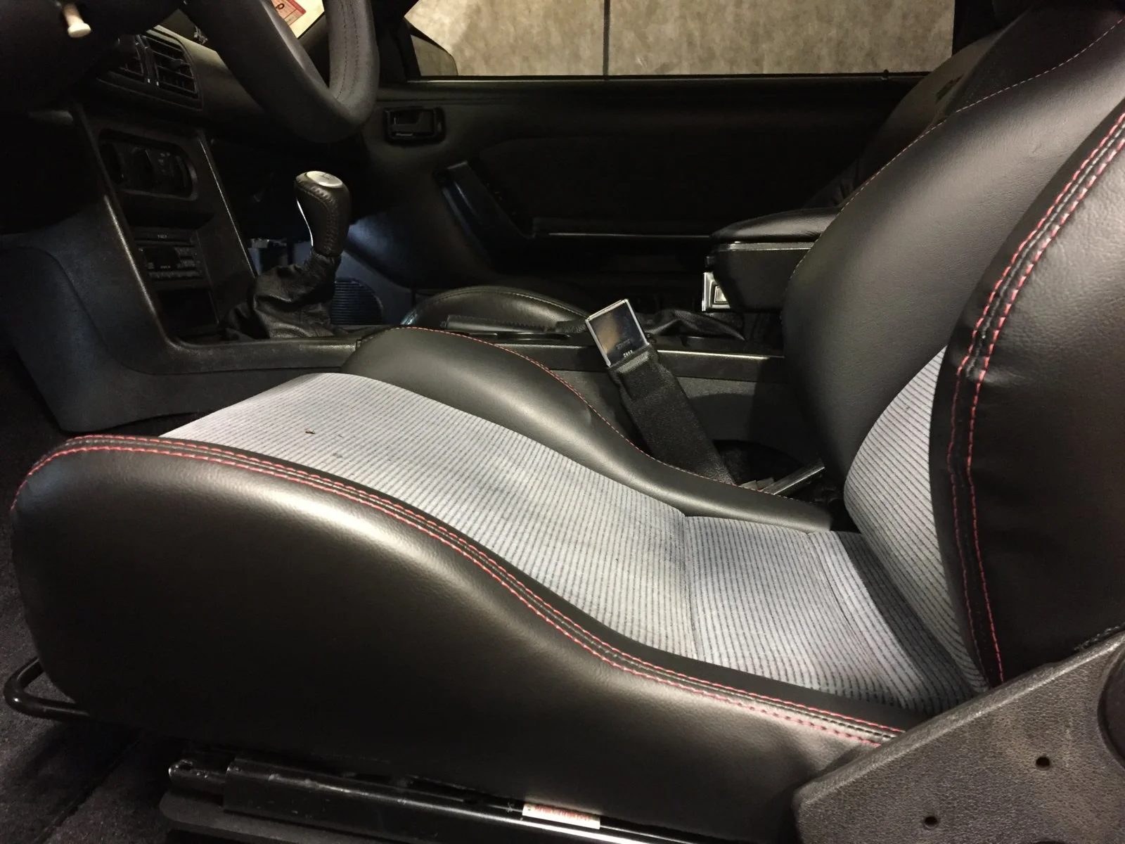

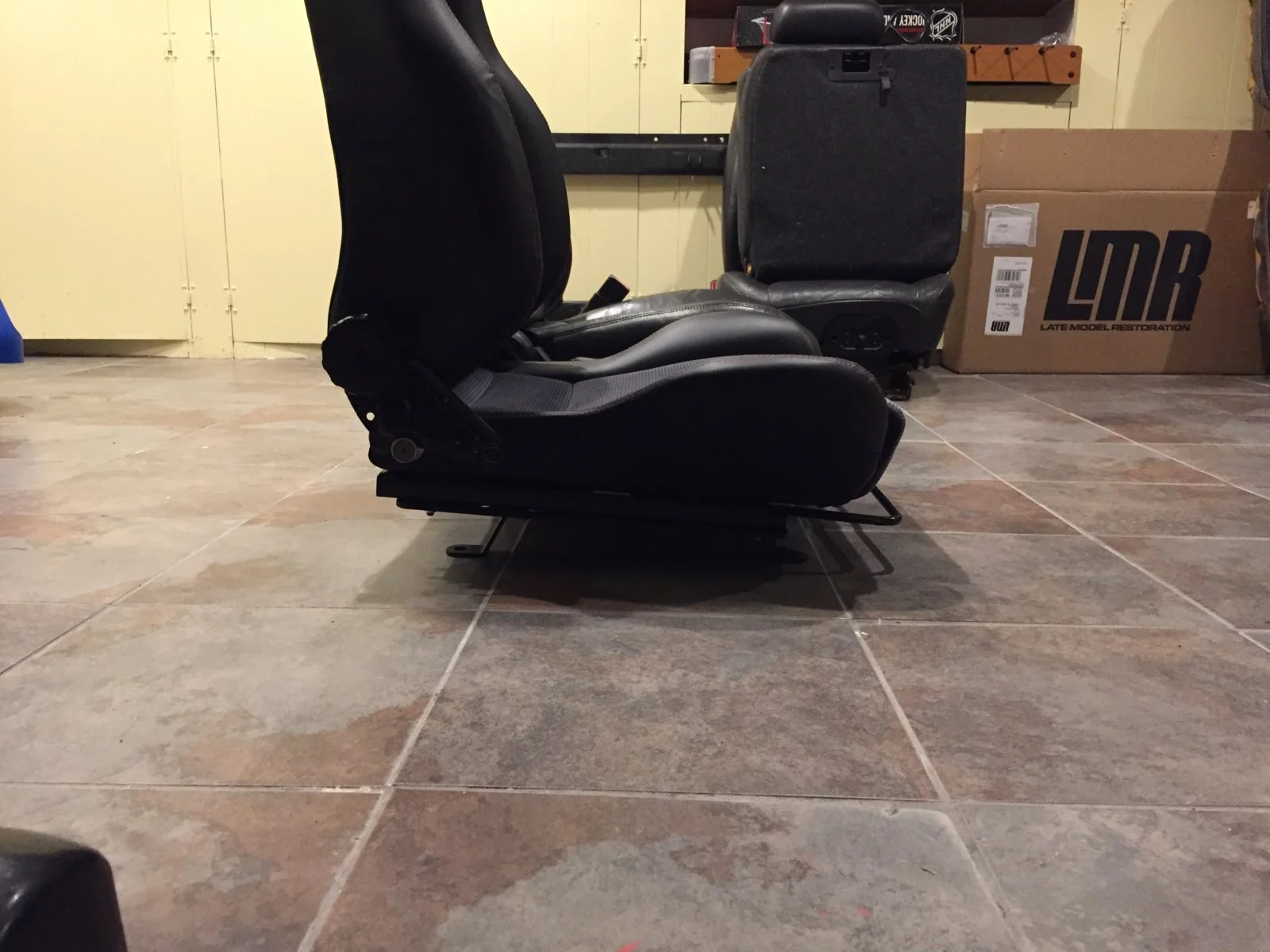

So, to be frank I am a bit disappointed at the height. Thought it would be lower. Looks like these sit only about 1" lower than th sn95 seat on manual tracks. Not quite the 2-3" I was hoping for. Of course, depending on where the adjustment falls, I could always remove the Recaro seat slider as that would lower the seat 1"
Oh one more thing that surprised me. Both seats with seat track installed weigh exactly 43.8 pound. What are the odds. Again, was hoping to shave a bit more off.
But, lets me just say this. When you sit in the sn95 seat...you sit ON the seat. When you sit in the Recaro, you sit IN the seat. The difference is quite substantial. So when I say I'm disappointed....I'm really not.
