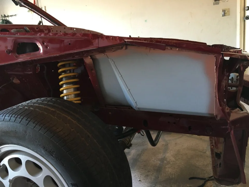

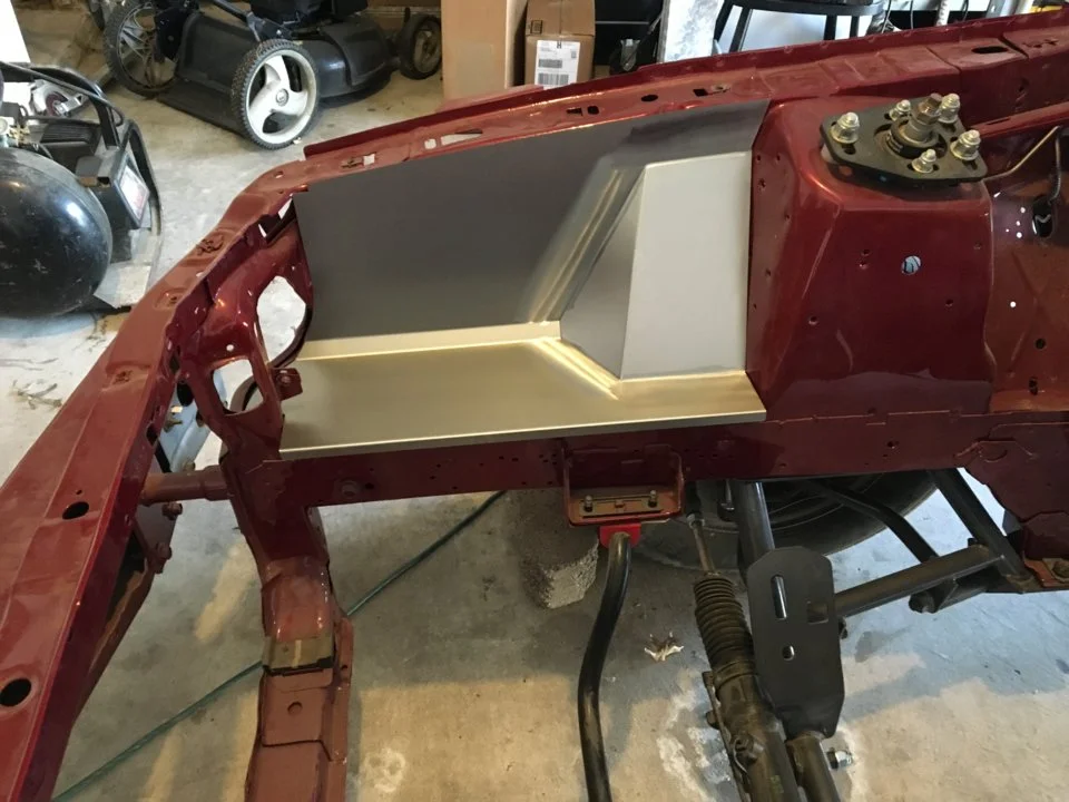

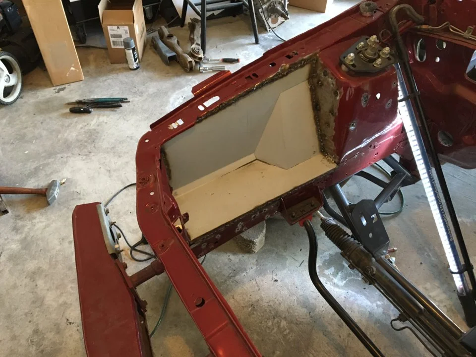

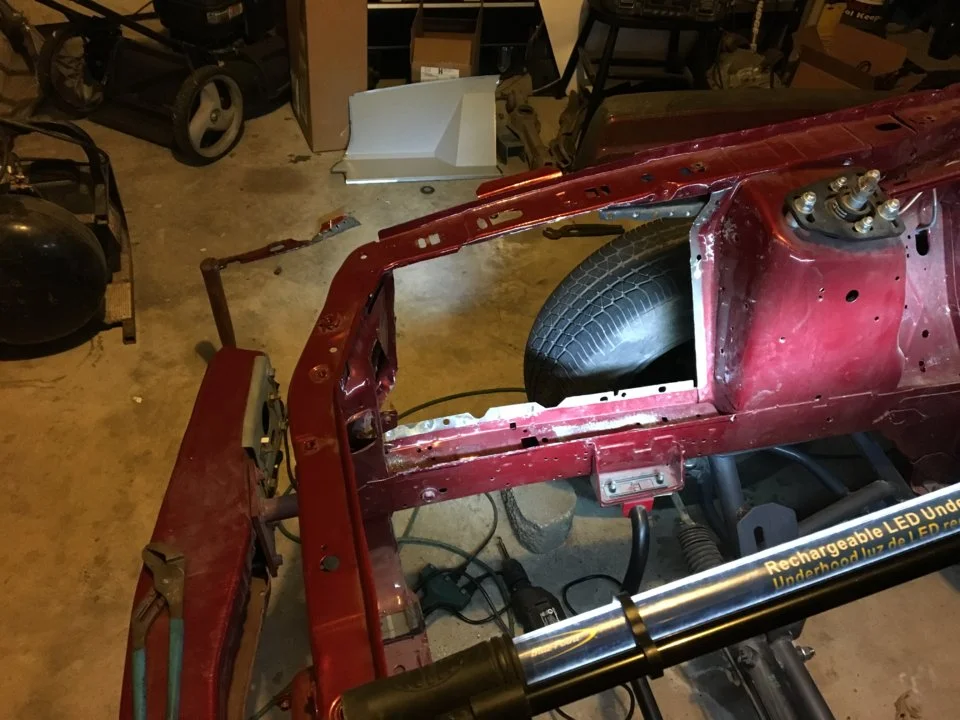

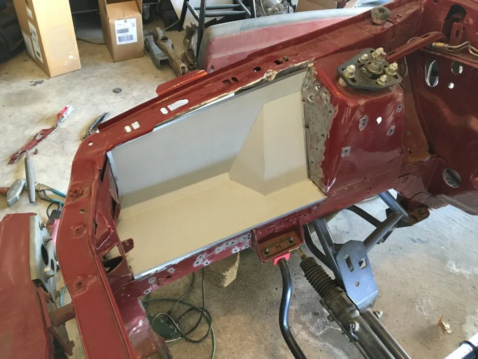

I started reading your build from the beginning, I've popped in her end there on it in the last few months to see what you were doing.I used as little filler as possible in the engine bay. Grind the welds down as smoothly as you can. The filler should just fill the little pin holes left between welds, not create the smooth transition between the panels.
The only area where I have had cracking in the past is near the sway bar mounts and where they mount to the frame rail. I welded the hell out of of that area and made it a point to smooth the welds to perfection.
As long as you aren't using gobs of filler, you shouldn't have any issues.
