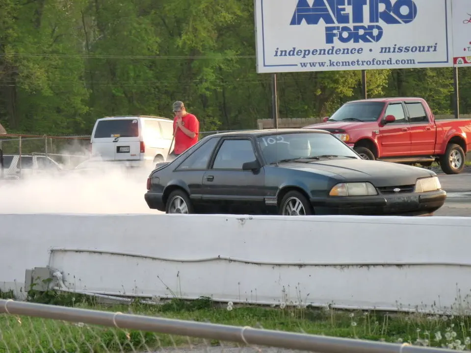

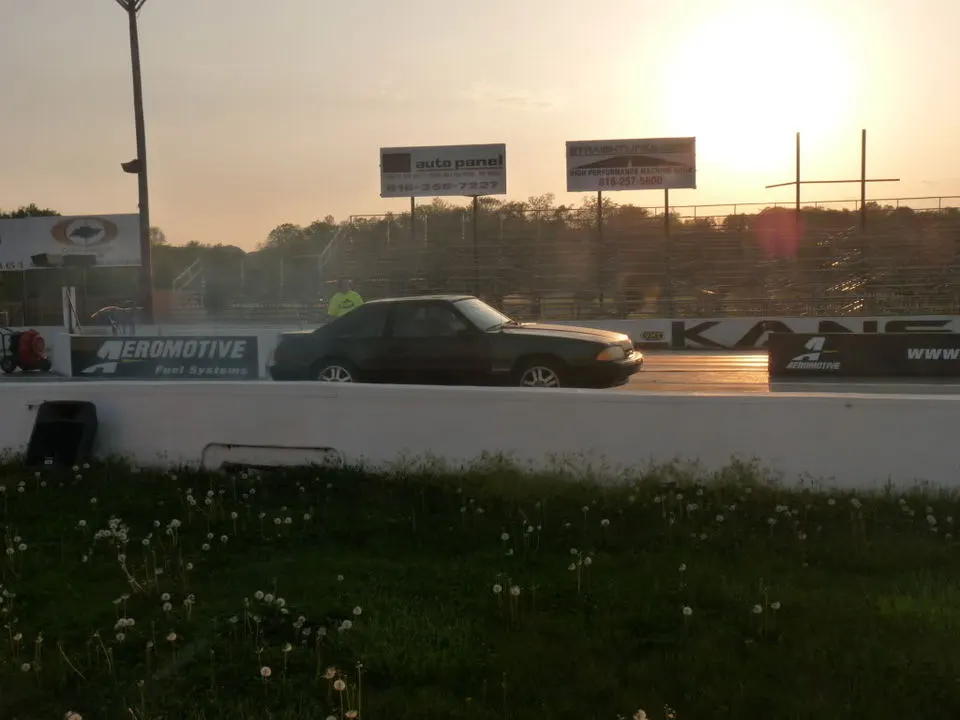

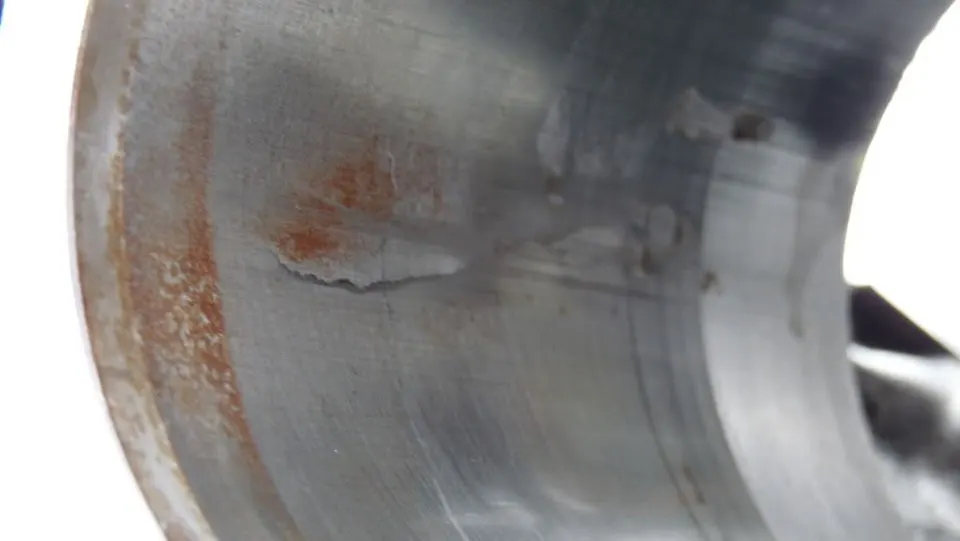

I'm putting the 2.3 back together, after cracking the block at the track last year. The poor engine ran a strong 12.36 at 111mph and was spitting white smoke out the exhaust after that. I drove her home expecting to change a head gasket, and found the a crack in the cylinder wall.

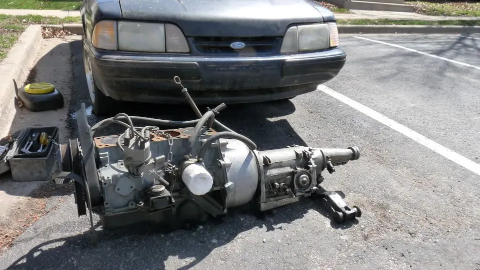

Not wanting to spend a lot of money, I picked up a used short block to throw in and have some cheap fun with. My previous engine was an E8 block and bored .030 over, which certainly contributed to it's demise.
