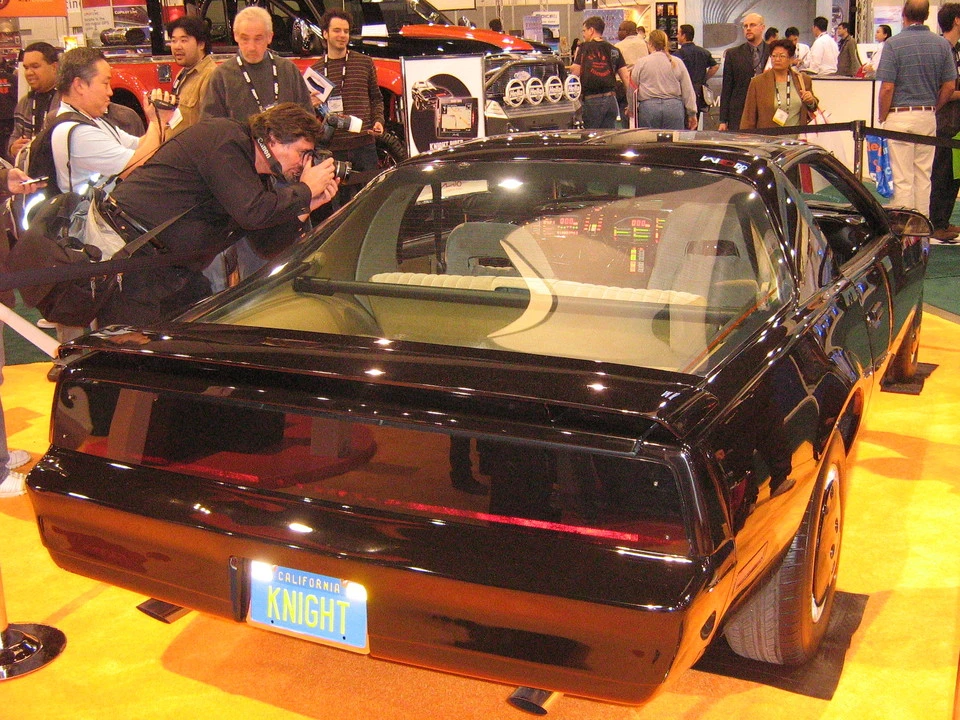

  2. The tails remind me of Knight Rider, but if you like them then thats what matters! Keep it up, progress is always fun to see.
  3. ^^^^ thats what i was thinking, loved Kit.

    A little bit yeah... I like it still :) great old show I used to watch with my grandpa. Too bad they dont make stuff like that anymore...
    Who didnt?!?!
