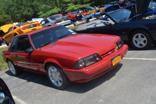

    [​IMG]
    [​IMG][​IMG]

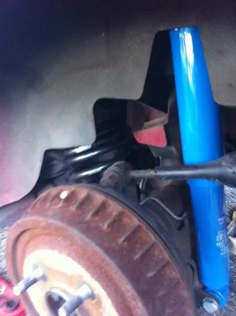

    Some pics my friend took with her Nikon at AM show and the rear springs and Tockicos are in !!

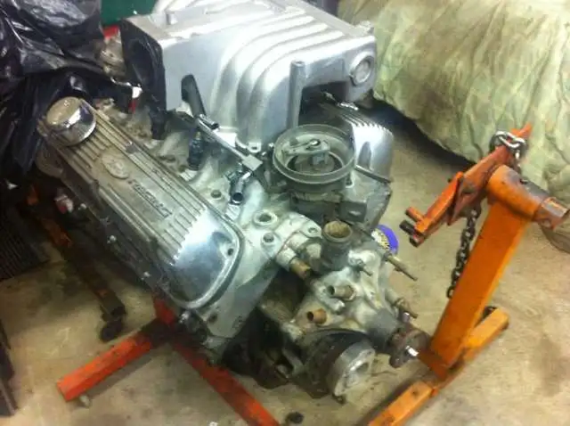

    So BIG update no pics yet-
    I had some of my specs off when i made the orig post
    This week comes-
    317CI Stroker
    Eagle roatating assembly Forged
    Comp Cam
    Edlebrock Performer RPMs
    GT40 upper and lower
    24lb injectors.
    Picked up a C&L 76mm for 24s , Spark Plugs, TOB, Antifreeze and misc gaskets and crap. Als0 have a RAM HDX going in it . Should be a nice little boost in power. Motor made 480 with a Vortech on it when it was built. Should make like 320-350 without the blower . Eventually i will go supercharged but i couldnt pass up the motor for the price.

    [​IMG] this pic was before I cleaned it up with simple green

    Nice. What kind of deal did you get on that motor?

    Picked the whole motor up for 1500- The rotating assembly is probably that alone. There is not a hole lot of miles on it its been ran and moved around most of its life.

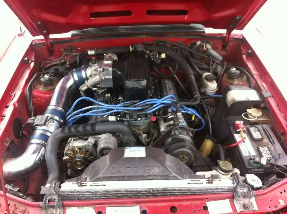

    [​IMG]:) started it realized had a bad vacuum leak , called it a night at 530 am sat morning . Realized that intake had a hair line crack in the runner ... downs box it is ! [​IMG] needs rear gears ASAP it is tricky to drive with the cam can't wait to feel the power once I do the rear but it feels and sounds awesome
    Started at 7 pm friday night. Motor was in and running complete exhaust and trans in at 430 am. Went home at 530 am. Back at it at 930 to sort little headaches. Drove it to work today

    SO i think the Downs is too much for the street plus my lower is not tapped for ACT sensor. So i orderd this up. [​IMG]

    Sweet thread! Love the updates. I love Simple Green!
    Can't tell you how much better the car looks lowered. Goodness gracious! Looks killer. How do you like the Eibach springs with the blues struts/shocks?

    Thank you , it makes it worth it to post when people notice!! I like the ride. It is not harsh doesn't jar you too bad but you still know it is lowered. My 00gt with h&r ss and kybs rode like it was on leaf springs, this is much better
