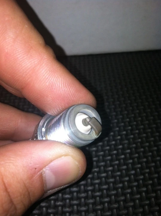

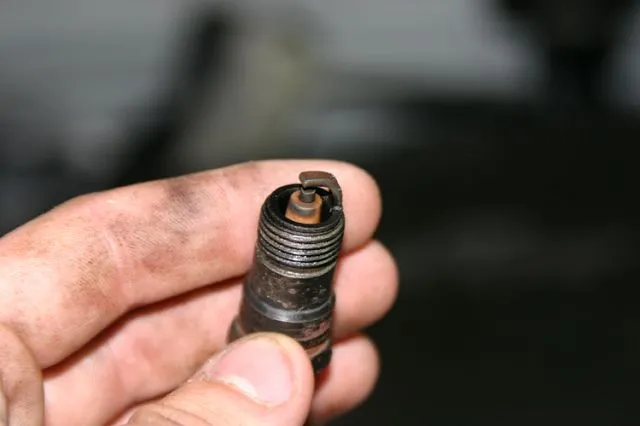

Here's pics of my plugs, doesn't seem to be a lot of consistency as far as color goes, but they all seem to have that small burn on the side of the porcelain. I am no spark plug expert so I have no idea what this means, can someone help?
that looks like oil to me in there....Here's pics of my plugs, doesn't seem to be a lot of consistency as far as color goes, but they all seem to have that small burn on the side of the porcelain. I am no spark plug expert so I have no idea what this means, can someone help?
A little blow by would certainly explain him being down on power.that looks like oil to me in there....
Well it runs fine..just not hitting the time I want to hit. I think I need more fuel.. Just did a compression test, seems fine I think.
