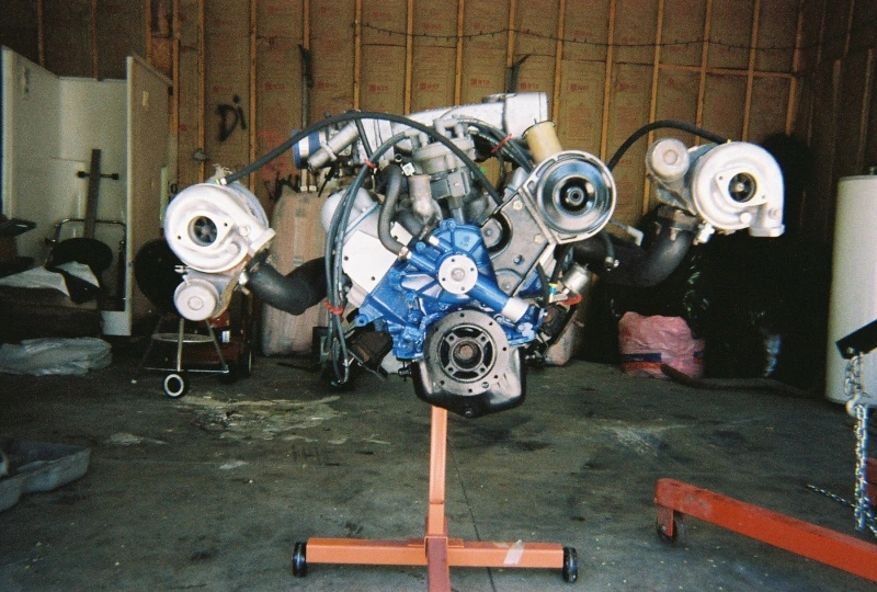

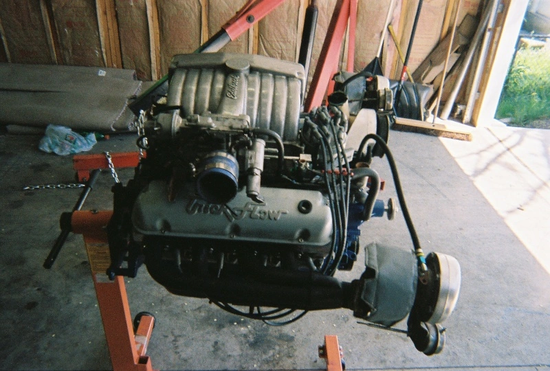

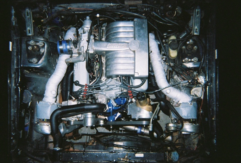

  11. Nice Job in my opinion! How reliable has this set up been for you? I have been looking at a Hellion as well as B&G turbo kits, but diy twins would be nice. How difficult was getting the tuning down?
  12. With the exception of a few self induced hiccups, it's been extremely reliable. Hell, I daily drove it during the summer 2 years ago (70miles round trip).
    Getting the tuning down really wasn't as bad as most make it out to be. It took me a bit longer as I had no-one to drive while I tuned....making every process a hair longer. None the less, it's one aspect I wanted to tackle....as I refused to take it to a tuner every time I decided to modify things.

  15. Still a great project . . . I just finished mine up about two weeks ago and popped an 8548 because it overboosted (15psi @ 3000 with a 9psi spring).
    Have a 2-step yet?
  16. Thanks guys!
    As for the 2-step, yep...it's hooked up and activated with the clutch pedal switch. I haven't been to the track yet with it functioning properly....so hopefully sometime this year I can improve my numbers. :nice:
  17. :D
    With my boost levels (~8lbs)...I probably don't even need it though, as the compressed air isn't nearly as hot as it would be if I were running say......14lbs. Regardless, it just keeps the IAT's that much cooler....allowing a more aggresive yet still very safe tune.
  18. Wow am i ever glad i came across this thread! I just started my twin turbo build on my 94, im using turbo coupe parts as well, but instead of the T3's, im using the IHI's from 87-88, still 7# i think. The only thing i did different is made exhaust elbow flanges instead of modding the cast elbows, and i may be running an intercooler. It sure is nice seing someone go through the work so i have something to look forward to. Nice notch, great job:nice:
    oops, just noticed how old this thread is, oh well, its still awesome!
