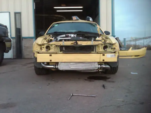

Monday 3/22 the install begins. I get off work pick up the parts and some tools and drive to my shop. Get there around 6 30 pm. Me and a buddy worked non stop untill 2 am and got all the piping ran and the turbo mounted. I had previously done some of the small steps to make the install easier. I had the maf bung welded to the intake pipe, i extended the o2 sensor ( On my 2000 i ended up not needing to do this so i just have extra wire now) and I had put my mmr oil pan on the previous tuesday (this has a oil drain back already).
I know alot of people question the quality and fitment of this kit, while i can not attest to the overall quality of the kit, the initial quality is A+. As far as fitment goes WE HAD NO ISSUES what so ever, weather it be v band issues or pipe fitment we had none. While i have yet to start the car to see if there will be leaks i have a feeling there will not be any issues. The kit also call for the use of a granatelli k member I used an AJE k member with 0 clearance issues.
There were two things not mentioned in the instructions (or that i at least did not see) that involve the inter cooler. We initially just put the power steering cooler lines like the stock setup (through the rad support) and then mounted the inter cooler in accordance with the pipes as mentioned in the instructions. I did not like how low this set up was and ended up moving the cooler lines out side of the support. The second thing was that there is a support from the bottom of the rad. support up to the hood latch area that we overlooked, but with the removal of that and moving the lines i was able to get the inter cooler up at least another 2.5"
As of right now my oil pan is still the lowest part of my car, but barely
