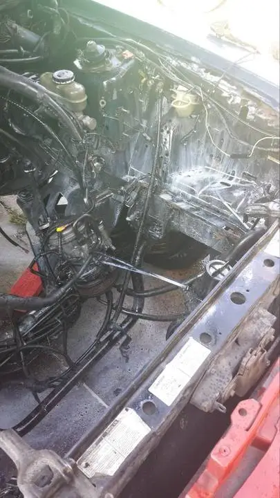

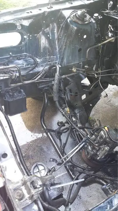

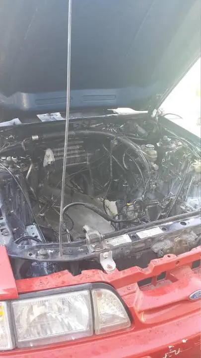

  1. I got a little bit done this past Sunday. I removed the SD engine harness and degreased and pressure washed the engine bay. It was nasty under that hood. It actually doesn't look drastically different. I took pics while we were waiting for the degreaser to do its thing before I pressure-washed. Of course I forgot to take pics after I finished. Anyway it's one step closer to progress. I still have to get under the car to get all that nasty $hit cleaned up....of course not to the extent that @madmike1157 or @RacEoHolic330 would go but clean enough for me to feel comfortable enough to put my brand new, pretty fuel system under there.
    Here are a few pics.

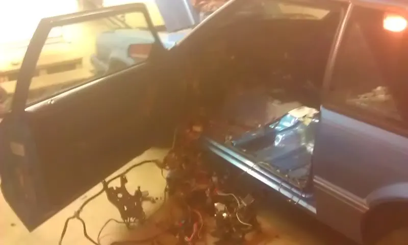

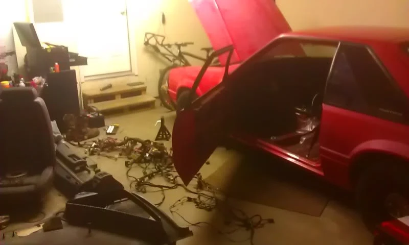

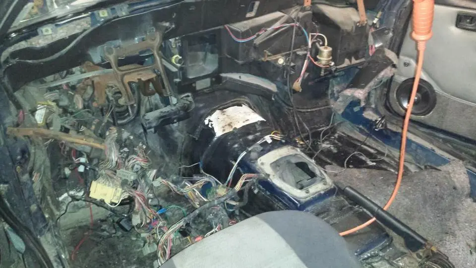

  5. More updates guys! not sure how I feel about this one. I'm feeling like I bit off more than I can chew but my buddy keeps telling me to stop worrying. I took my dash out to replace it with the black 93 dash. I don't know if I ever mentioned that I HATE messing with wiring. :nonono:
    Here's right before the dash came out. I remembered to take pics right after we took the steering column out.

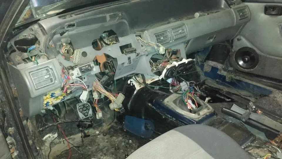

    Here is after the dash came out. Here's when I started to worry. I didn't realize that the wires didn't just unplug at the dash. I thought everything stayed in the dash and it just unplugged from the rest of the harness.

  6. you'll be fine keep on trucking . I did mine in 3.5 hours from start to finish one day

  15. take a deep breath. i had my car torn down far beyond where yours is doing my 4cyl swap, and it all goes back together. you just need to get the right engine harness, that 93 is not going to work. dont go carb, thats a step backwards.
    what exactly are you trying to do with the dash and harnesses here? mass air swap?
  16. Mass air swap and black dash. What exactly do I need to make the 93 harness work? I have access to damn near every wire out of the 93 because my buddy is putting a Terminator motor in it with the matching harness.
  17. ok, if you have the car torn down that far, just yard out the entire body harness from the 93. learn how it comes out. yard out your 88 body harness and replace with the 93 you will have to wire it from where it pops through the dash all the way back to the rear lights and fuel tank. ITS NOT THAT BAD. just set aside 5 hrs and do it.
  18. when you get the 93 harness out, lay it next to the recipient car. get the 88 harness out and immediately go back in with the 93 so you dont have time to forget. i feel you man, at the point in the pics below, i was like, why the hell did i ruin two good running cars? youre in it this far, finish it.
