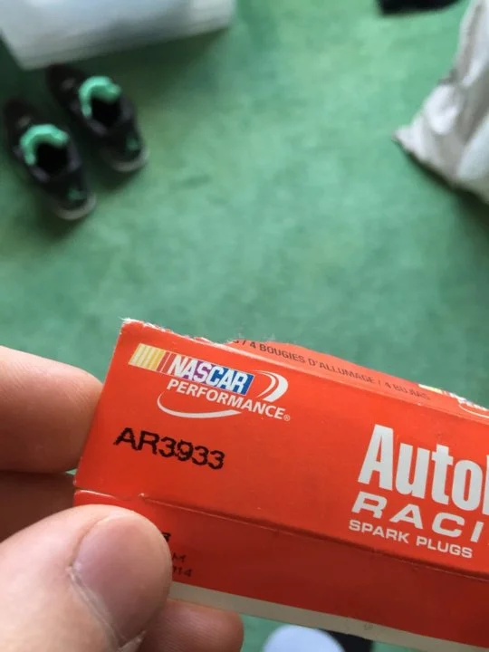

I orderd the case of 12 on eBay for like 75 bucksOk, so where do I order this Brad Penn oil from for my 363? And Autolite 3933??? Do you mean 3923 or is the 3933 a special plug for boosted applications?

Case of 144 ? And to think I was cringing over 63 bucks for 16 lolThe AR3933 has a cut back strap and is specifically designed for racing applications. The strap is cut directly over the electrode making a more direct path for the spark, I like to use these or the NGK V power plugs in boosted applications. The autolite plugs last a lot longer than the NGK plugs in my opinion but are more than twice the cost. We sell the autolite's for 5$( or somewhere in that neighborhood) while the NGK's are 2$ a plug (Granted I buy a case of 144 at a time to keep in the trailer). I personally change a set of plugs every pass or every other pass looking for detonation and discard them afterwards, the cost savings is what I look at for me. For a boosted high horsepower application the autolights are the go to as you should get a season out of two sets of plugs if you're running it hard and the tune up is spot on.
